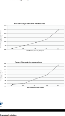

When I pulled my factory assembled bottom end apart it had half grooved mains. Check Clevites website to see the oil pressure loss when using 180° grooved bearings as the baseline vs. 360°.

So does the chart that I cannot read say that my perfectly fine oil pressure with full groove mains at 0.003" and full time rocker oiling using my standard pump is my imagination?
I was referring to my 440 as an example. The chart (which I can clearly see by clicking on it) shows the potential loss in pressure with respect to increasing the grooving from 180° to 360°. It's an additional leak path. When I switched from a SV to a HV I saw a 10psi increase across the board. It's now right where I like it using the same SV spring.
Sure, that makes perfect sense. And you now have the pressure that you like. Perfect. But to imply that you need a HV pump because you have full groove main bearings is incorrect.
Never said it's a requirement. It was a personal decision that improved the pressure readings to a more desirable level. Maybe Bob Renton can clarify things since I was discussing switching to the hv with him at that time. If someone wants to run a SV pump and is happy with what they have, fine. If not, it's always an option.
