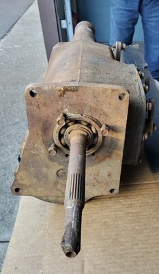

First post here, but I have an inquiry. I’d like to put an 833 in my ‘72 Charger at some point down the line, so I bought one trans that shifts into all gears and spins freely but it has the A body tailshaft. In that same deal, I got another one with the B body tailshaft for really cheap because it either won’t shift or won’t spin freely, thinking I could swap the tailshafts. I’m new and have never messed with transmissions, so am looking for confirmation that this is possible. Also, they both have the ball and trunnion setup. My driveshaft should be slip yolk. How do I overcome that? I’ve heard about conversions, but don’t fully understand. Hope you all believe in the philosophy of “no stupid questions.”
You’d need to change the output shaft, that’s a tear down of both transmissions. But yes, doing this will give you the trans you need for your car.

That would be cool if it were that simple. The bearings and stuff definitely need changing anyway, based on the pictures. I’ll know more once I get my hands on it and dig in.
Tear both transmissions apart. Keep separate. Take the short tail shaft, pit to the side. Take the long tail shaft, put it next to the A body trans. Take the output shaft of the B body shaft, put it next to the A body trans. Take the A body output shaft and set it aside. Now you have what is needed to make a B body trans. Look at the big bearing on the B body shaft, is it the same size as the A body bearing? If so, great, order a new bearing. Install it. Slap the now complete A body trans case to the B body tail shaft (you should’ve installed the B body output shaft into the A body case. Slip the B body tail shaft over the output shaft get the snap ring seated. Put the cover on. Now you have a B body trans. All you’ll need is new linkage, new thingy’s that bolt to the shifter studs, possibly a shifter. This is not hard to do. Get the book by Passon, you’ll be set. Set aside about 4-5 hours if you’ve never done it before.

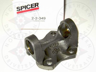

If you have to have a new driveshaft made anyway going to the slip yoke then might as well make a new driveshaft that uses the drive flange on the ball and trunion. Spicer makes the adapter I believe. Any driveline shop should be able to make this happen.
And here it is
https://www.amazon.com/Spicer-2-2-349-Flange-Yoke/dp/B00GAPJQC2
Then get the U joint and the slip yoke setup. Your drive shaft will look like this
