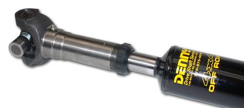

      You still need to have a driveshaft like this in order to make it work.

      Probably a dumb question, but why?

      Something has to compensate for the rear end going up and down as the distance between the rear end yoke and the end of the transmission changes. That is the function of a slip joint or when applicable the ball & trunion.

      Huh. I figured that if I used an adapter on the trans, it would effectively create a complete slip joint, wouldn’t it? Also, the driveshaft pictured is obviously a Dennys unit, but exactly what driveshaft of theirs would I need? Like what’s different about it compared to the one I have? Apologies for my ignorance.
