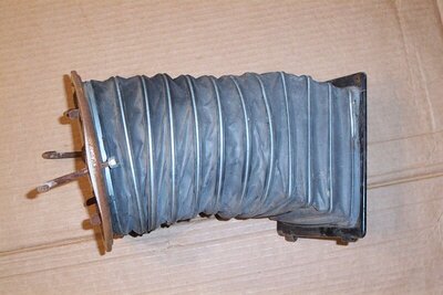

I want to put the heater/defroster unit in "Jigsaw" but I am lacking the one big duct that connects to the right side cowl vent. Anyone have any info on who sells these?
The heater box has been gone through, I just need the big duct on the right side.
I can't install it until I get one.

I think we need a picture? Air? No air? only the black rubber doughnut on right side with no air.
Just went thru this in the last year restoring ac/heater box. tried repairing ripped material several ways. I thought I had it fixed until I tried mounting it. That 90 deg. turn was way too much strain and the material just ripped away from the square section. I searched all over for replacement but could not find any. Blocked the part where it comes from the cowl with the original round collar so no air comes thru. I will use the left side vent to get fresh air into the interior. Good luck finding a replacement. Heater box only may have a different right hose than the ac/ heater unit.

A/C box uses the big inlet duct. Jim at DMT was thinking about making these. Might try him
That AC duct can be a tad tough to come up with.
They were made from some kid of light fiber material, almost like paper . And are usually cracked or torn AND are 1966 thru 1970 B body with factory air only
I used drainage tile for defroster ducts and functions fine until you can find OE or OER. It comes in various sizes and may be adaptable to the heater duct as well, so you can get it on the road.
Gates sells air intake hose for air cleaners that could be made to work for the a.c. cars in a pinch. Could start with the right diameter and mold it square on the end. Rockauto had the 3".
