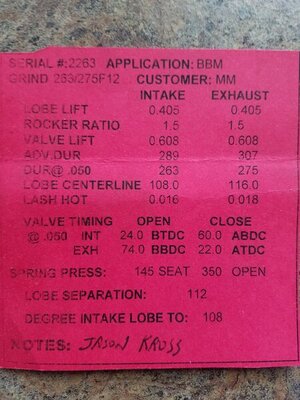

Hey guys, looking for a little help on some things here. Back in 17 I had muscle motors of michigan build me a short block 512. I wanted it to run on pump gas, use my indy big EZ heads, and when they asked for a horsepower target I said let's go with 700. The horsepower number I understand can be fairly arbitrary but they asked and I picked one. It's in my 66 belvedere street car.
From day one the motor leaked oil like a screen door in a submarine. The motor makes great power and pulls like a freight train when it "feels right" but I feel like there should be a lot more to it. Compression is right around 10.5 to 11:1 so it's right on the brink of pump gas (from what I understand) I've got both 3.55 and 3.91 gear sets for it but only ran with 3.55 so far. I'll post a pic of the cam card below.
It's got a cope trans, with a muscle motors spec'd PTC converter. I think the converter is way too tight but they did tell me the motor was designed start making lots of torque fairly low. Either way, I can't hardly "get up" on the converter at all in a street light race scenario.
And after reading another thread on here about blow by, I think it's time to open it up for a little exploratory preventative surgery.
1) do we think it's cammed right?
2) will this combo hit my goal if 700+hp (I want low 10's once the suspension works right to smoke my neighbor's stupid z06 corvette)
3) should I opt for more compression and run better fuel or switch to methanol? We don't drive the car anywhere near as much as we thought we would so more power=more fun in less time right?
4) should I be able to rev, say maybe to 2500rpms or more, the engine before getting too much forward travel?? I've never driven a high stall converter and to be honest, not sure what to expect.
I'm sure I'll have more questions as this thread progresses, but this post seems long winded to begin with! Thanks in advance guys!
The lift is ok, your duration is real good, but the lobe separation is not good for your street combo. 112* tames it considerably. A 110* would be better and a 108* would really wake it up in the low to mid range power. 108* works good in heavy cars, it makes the engine come on sooner and harder making the car much more fun to drive. 108* may not be good with power brakes thou as you will have lower vacuum at idle in drive. I have a SFT 270/275@50 on a 110* with .650 lift and works real good in my 12.5:1 511. You would be much happier with a 110* lobe sep and the convertor may use a loosening to get some real good performance. My vert is a 8" 5500 stall and works really nice on the street, but i do some track time too. Good convertors don't have much noticable slip. I once had a sb408 with a cam on a 112* lobe sep and a 3500 stall. That combo was a pooch off the line, not a good combo for performance. Hope this helps.
Ok, should I go up a little in lift since I would need a little help in the lobe sep. anyway? (1.5 harland rockers) Has a solid flat tappet cam, would a roller be better? When we put it together there was thought that aftermarket solid roller lifters don't last on the street. It has manual brakes so vacuum is not a worry. Is there a way to loosen the converter? Not sure if it's something that can be sent back and re-done or i just order a new one. Sorry for the elementary questions, just want to get it right this time as I'm a little pissy of the money that was spent at muscle motors for the product I got.

I also think the cam is a bit off. How much does the car weigh? I’d bump the compression if low tens is the goal. Your also gonna need a convertor that flashes well into the mid 4 range or better. If it’s a PTC 9 1/2 they should be able to accommodate that. Sounds like something is a miss with the combo. I wonder if the cam was in retarded. What’s the intake/carb? Low 10’s on a b body requires a stout combo.
PRHeads knows way more than i do about the cams, but i like flat tappet, you just need to use very good oil, EDM lifters(direct oil) and keep an eye on lash. Rollers are only a 10th quicker most claim and good bushed roller lifters are very expensive. PRH picked my cam for my combo. He can get you what you need. Yes, convertor would have to be sent in to recalibrate if thats what you want to do. Are you looking for street/strip deal or just street? I think the 3200 stall and your gear are holding you back a bit as well. I think the 3.73 is a good street performance gear.

Your car is heavy, so the 112*lsa, your 3.55 and tight convertor are all hurting you if you want to run low 10's. Their has to be some compromise here to get where you want to be.
I'm gonna have to pull it down to look at things for oil leaks and inspection anyways, can't hurt to swap a cam. Maybe I'll switch the cam and rear gears (since I already own them) and see what it does. I'd like to swap out the old steering box for an update while i'm in there too but that's another topic.
