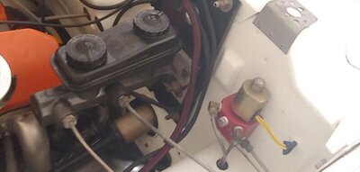

Here is a photo of my master cylinder/line lock. The line coming out of the front of the master is what feeds the rear brakes, there is no proportioning valve like shown in the video.
When you bench bled the master are you sure you bled both halves. Lot of people make that mistake. I would re-bench bleed the master making sure you are compressing both halves. Then one all the air is out re-install the master, leave the caps off and gravity bleed one wheel at a time. Then do a pump and bleed one wheel at a time untill no air comes out. Are all your caliper bleeder screws on the top?
yes, the caliper bleeder screws are facing up. The master cylinder has only one reservoir under the caps. There is do divider in the master separating the fronts and rears.
There should be a divider wall it is lower in the reservoir.
