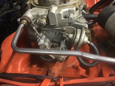

I have drawn a Yellow line to where the choke rod connects to the carburetor.
the engine posted is a 1970 but same hook up and choke diaphragm
8718895E-757E-471B-9B38-BF41936ABAA6.jpeg 8ADEC39A-3B6F-40EA-A268-2D7A53EEC082.jpeg 6C78F81E-3212-4CC5-9C6B-0785B482AA1B.jpeg
thats the piece i have been trying to loosen so i could put it on an eddy carb. they must have used locktite on it because the retaining screw will not loosen. by any chance do you know if its left handed threads like some lug nuts? :-)
