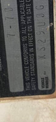

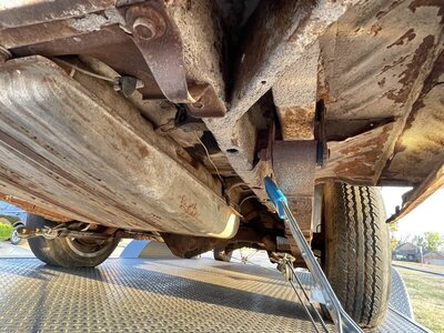

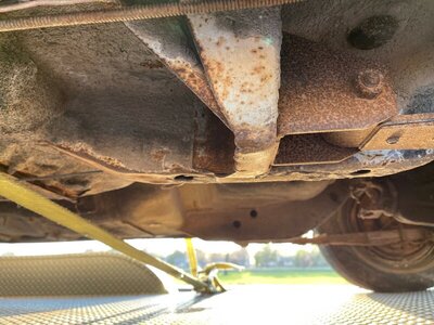

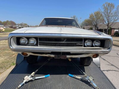

Supposedly a 70 RT track pack car, any input on errors or value?
TexasRoadRunner68
5:44 AM
Jul 24, 2013
598
229
Dallas,Texas

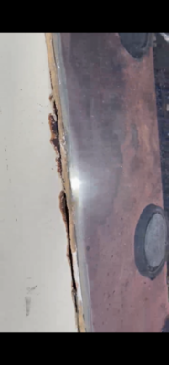

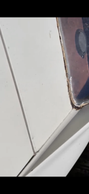

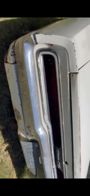

A guy relatively close listed this 70 RT. Supposedly has numbers matching 4 speed (18 spline) with 3.54 Dana 60. Appears to be a white car, no vinyl top with c stripes. Very basic aside from that. No AC, drum brakes, etc. the interior looks like it was burnt orange, but the dash looks incorrect as I thought 70 RT cars had woodgrain dashes. It needs the rear lower quarters, valence corners and around the bottom of the rear window. Fender tag is missing, but it possibly has the build sheet.
He’s asking $25k, no motor.
Does this appear legit? What’s the realistic going rate these days?
82A9655B-CBB2-4AAD-8472-99C35D56D069.jpeg D8C06F60-950B-4FE3-B019-59049C074189.jpeg 761C7A26-E995-4243-9431-6A3821D9443D.jpeg 59EDB82D-6B0B-48C9-AE18-A2ED7AD285D4.jpeg 3ABB3BB6-5C9C-4D12-BBE7-CD772C83AE7C.jpeg
I believe thats the going rate.,A guy in Chicago sells rollers for 20 on up. Grab it if you can.
For a R/T 4spd car? I'd say it's a bargain...
My concerns are the missing Fender tag. Not sure if the build sheet is there. The driver seat is black, not orange, and for some reason it has a 68-69 dash. Supposedly the vin matches in all places. Just trying to make sure it’s the real deal.
70 would be wood grain. I know the feeling about the fender tag. My Bee didnt have one. If its solid I dont think you can lose on it. Vin should tell you if its a 440 car. Does it have the dana?

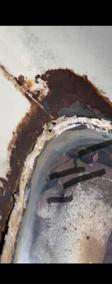

Yes, supposedly factory Dana 60 with 3.54 gears. It will need lower quarters, window corners are rough, bottom of window frame is rusted pretty good. XS and U code, which should be 440 R/T.

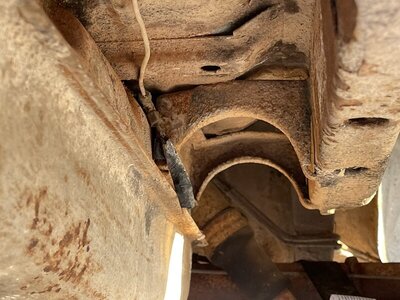

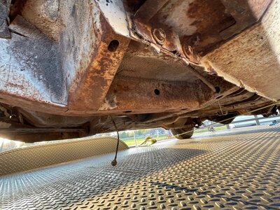

C98770D0-7712-4460-B73E-B6B5707848B4.jpeg 07F58704-F3C4-49EE-BB73-F8392D31B633.jpeg
offer 18 and go from there,Ive been looking and chargers are CRAZY MONEY.
This is what you need to ask yourself, can you do the work on the car? Is this the dream car? You will dump another 15 on up to restore it. These cars are money pits. Like I said Im looking for a charger and debating if its cheaper for a car almost finished then a project. Once your over 40 I want a fender tag. Good luck.
Even with all the rust and missing/incorrect interior...you’d go $25k? I noticed the valance corners are rotted...hopefully there isn’t a ton more hiding. I’ll try to get trunk photos.

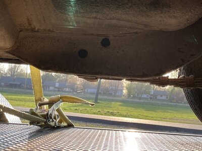

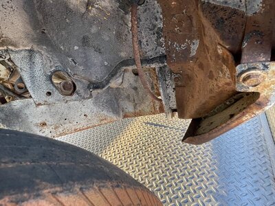

From what I see the frame looks good.
But I think it might need a floor.
Hard to tell with the thick plush carpet in there. Wow that's ugly.
