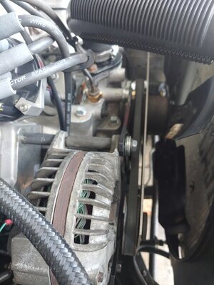

Hello all I'm having issues with my belt coming off at high rpms. What have anybody done to help fix the problem
Thanks for pointing me in the right direction

Take the belt off, and look carefully at the pulleys for damage, specifically pinch points or damage caused by rust. Also, check the grooves for taper issues like excessive wear. Look at the belt itself for any kind of damage as well. Make sure there's no problem with the mounting of the crank pully....like start the car for a few and look for runout or wobble..... same with the bearings on the alt and water pump... give them a spin too. Check the mounting on the alternator while the belt is still off... any movement?? If so, the alternator will bow out as you tighten the belt. Take your straight edge and lay it flat (90 degrees from how you show in pix) alongside the pulleys to look for proper depth, and make sure the straightedge is long enough to reach all the past both sides of the pulleys you are checking. Finally, don't overtighten.... and use a belt tension gauge to be positive.... In the HVAC world, I use a Browning and it gets me by, but there are others specifically for autos I'm sure. Can you provide better pix of the mounting on the alternator side??

This is a new belt I purchased this morning. I spun both the alternator pulley and it seems fine same with wp pulley because the other time this happened belt actually broke I spun it by hand just get some water moving threw the engine. I do notice that the belt shakes between alternator and crank pulley
I know this sounds simple but are you sure the belt is tight enough.
Should not be shaking between anything unless a bearing is seizing up
But it sounds like you ruled that out.
Also is that a straight edge in the picture showing your alignment is good
Between w/p and alternator ?
What about crank pulley alignment to either of those ?
Throwing out ideas.

Yes it a L shape ruler picture is probably hard to see on the crank pulley
Sure looks like your belt isn't tight enough. Why do you have the extra thick washer on the alternator bolt? Could the belt be flopping around enough at higher rpm's and hitting that bolt head? Also take the belt off and check the 2 pulley alignments with a beefier straightedge.
Any of your brackets bent? One picture from drivers side alternator looks like the far side looks at an angle so alternator pulley isn't square water pump pulley.

Washers are there because of spacing everything out the damper is a ATI . are you saying check the alternator and waterpump pulley alignment or crank shaft and alternator

I see the extra washer under the bolt head to the alt bracket.
Check both the alt and water pump in relation to the crank. Take the belt off first and spin the pulleys as you are checking. Should be able to tell if one is bent as well as in or out to far. The water pump to crank will be the most important imo. Use a thicker piece of stock than a flimsy square to rule out flex in that.
440 Source sells crank pulley shims if that would help.....
Wonder if those washers are pushing the bracket causing misalignment.
I added them because first look waterpump pulley was clearly not aligned. I'm going to pull the radiator maybe that will help with better access for checking everything closer
