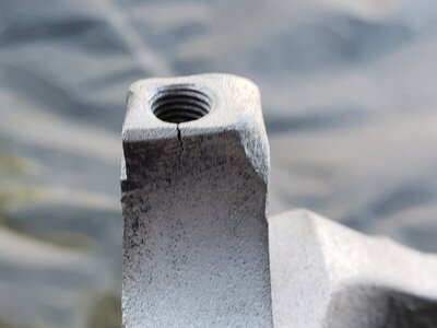

So I'm replacing my pinion seal on my 489 sure grip rear as well as the yoke as I discovered a crack in one of the bolt holes. My question is has anyone done this and did you have to remove everything from inside the chunk to get the old crush sleeve out? I pulled the pinion nut, yoke and bearing out but now the crush sleeve won't come out past the bearing race. Right now I'm feeling like cleaning and lubing the bearing throwing it back in and throwing the new seal and yoke and calling it good.

Crack is in the yoke I have a brand new one that was why I removed the pinion bolt and original yoke and bought the crush sleeve Eliminator. Now I'm thinking might as well rebuild all bearings and change gears if I have to disassemble everything.
