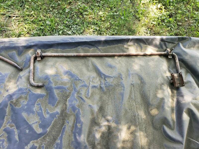

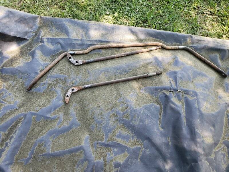

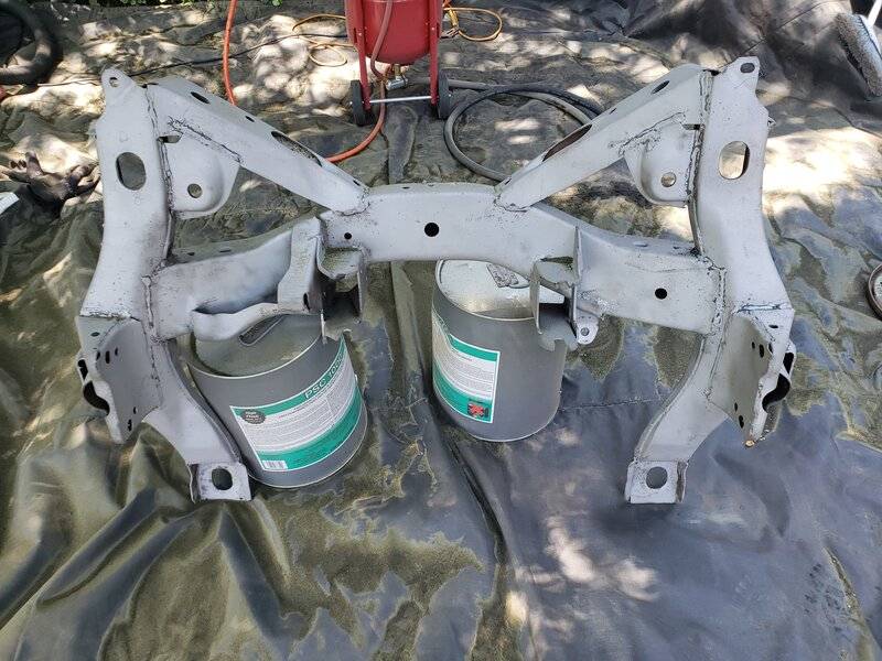

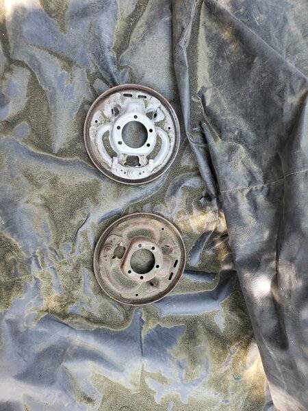

I'm definitely going to dive back into that chunk this weekend. Today is sandblast and paint everything day. Gotta get this stuff done while I have dry weather in the 80's.
20210806_125016.jpg 20210806_124946.jpg 20210806_124952.jpg 20210806_125003.jpg
