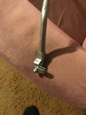

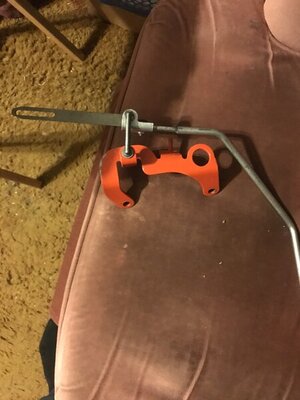

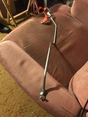

The bracket on the intake is a little different. Also the lower rod. This is on a 71 Charger with 440. It’s a 383/400 bracket with a 440 rod. The rod will have 758 on it A 440 bracket has 2 straight legs. The 383/400 bracket has the front leg curling back a little. I think I have 1 more set up. Kim
30BDD087-3EEF-4099-BE24-5736289F5B3B.jpeg 7C34C914-BD3A-4251-9F14-9F4AEEF39975.jpeg 124E56E6-B3D6-4115-B697-F7246D73AC2A.jpeg 004317F5-524C-4A31-A573-27799AD329B5.jpeg
This is what I have, so far. The rod was way too short, which wouldn't allow me to get anywhere close to proper adjustment. Don't mind the old out of place springs.

His bottom rod is way to short. What length is the rod and how long is the lever on the tranny? 2 inches or 3 inches? Kim
Also the picture shows the wrong kickdown spring attached to the wrong part of the linkage . it should be always holding the rod full forward in order to properly control the line pressure.
