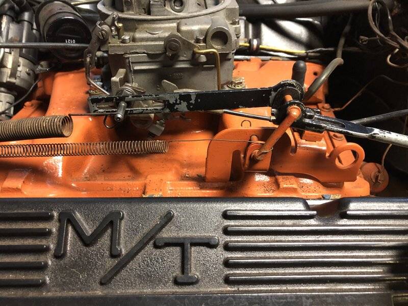

Also the picture shows the wrong kickdown spring attached to the wrong part of the linkage . it should be always holding the rod full forward in order to properly control the line pressure.
Leo, if you had read what I had written when I posted the picture...you would know that I know they are in the wrong positions. They are going to get replaced anyway. I moved them for picture clarity

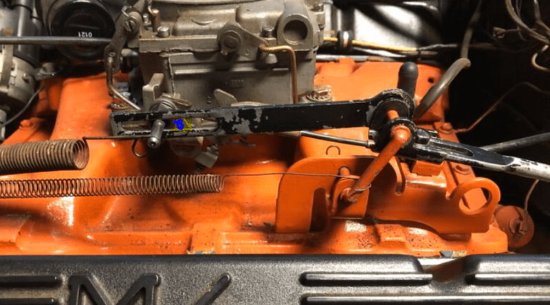

This is what I have, so far. The rod was way too short, which wouldn't allow me to get anywhere close to proper adjustment. Don't mind the old out of place springs.
