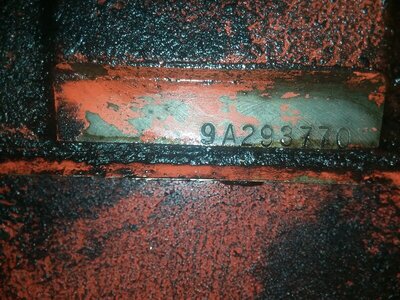

Hello, hoping people can post me examples of their block VIN number stampings in order to help me determine if a car I’m looking at is legit. It Looks slightly ‘off’ to me so far.
I’m looking at 1971 car
Especially ones built at Hamtramck
Thanks in advance!

This is the one in question. It’s completely missing the plant stamp (Hamtramck) and to me it looks like the last 4 are a smaller font size and physically aren’t in the same line as the first two numbers of the sequence number, the last 4 numbers look smaller to me too.
The ‘1’ also looked deeply struck vs the remainder but a after seeing @dadsbee stamping I’m a little less worried about that.
Maybe the faint stuff is all normal and good but the 1’s make it look off. Not sure
If he was going to fake a stamp (re-stamp) wouldn't you think he would do a better job? Just askin.....

Well that’s a good point. It wasn’t the current seller, he bought the car that way and I guess you never really know what one would do in order to make a fake.
No, a 340 car

Okay, the small block drainplug confused me. I thought it might be a cross bolt main. My big block doesn't have a plug there. Not as familiar with a smallblock.
Remember they swapped in new stamps as they wore out. Ones on all my engines are cleaner than all the other numbers, guess they got fresh 1 stamps. This one has a crisp 1 and 5 and the 8's are pretty beat... and yah that B has almost done it's life.

People think things were constant.
Things change.
Compare apples to apples.
Don't try a base the legitimacy of a 71 Hamtramck stamp by looking at stampings on a 69 Lynch Road car.
