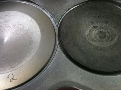

I had read a thread on a forum when those heads hadn’t been out all that long where a guy bought a whole top end package, and when he was mocking everything up discovered the valves were way too long.
That seemed king of odd to me, but who knows.
Then a few years later I get an early set here to repair.
They had been run on a pulling truck for a little while until they dropped a valve.
Turns out they had the way too long valves in them too.
But...... not only were the valves too long, they were too big around and were clipping each other.
The guides were totally shot........ which was a common issue with early PC heads.

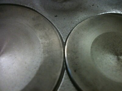

I'm thinking they are early heads.....especially if the guy he bought them from is calling them Pro Comps. The seller's dad passed away awhile back and he's been selling off all of his dad's stuff and the heads were the last of the parts....and probably for good reason that they were the last to go. My buddy traded him an old 4 wheeler that needs work and only paid 300 for the 4 wheeler so he's not into them for very much. He's supposed to bring the heads over today or tomorrow for me to look at so thanks for the heads up. I have read about the valves being too long but didn't read anything about them clipping each other but that has always been something I check for anyways. Still have an old manual spring compressor so may pull a valve to check the length....
Valve length should be around 4.88, right?
The intake valves are a pretty common length. Same as a .100” long BBC, so there are plenty of diameter choices for those.
.050” between them is plenty.

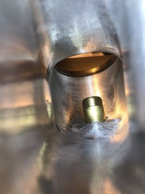

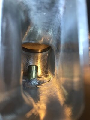

The ones I had here with the 1.88/2.25’s..... they were more like .005”-.010” apart.

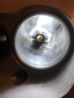

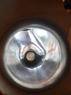

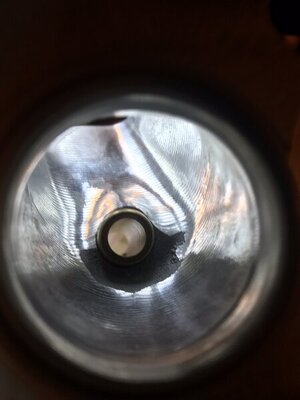

1.88/2.25:
1.81/2.20:

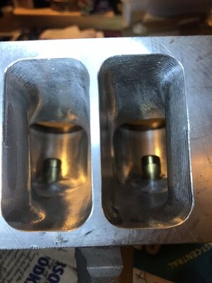

Kimmers intake port openings look bigger than the one set of cnc ported SM Victors I had here.
Are those MW size?
