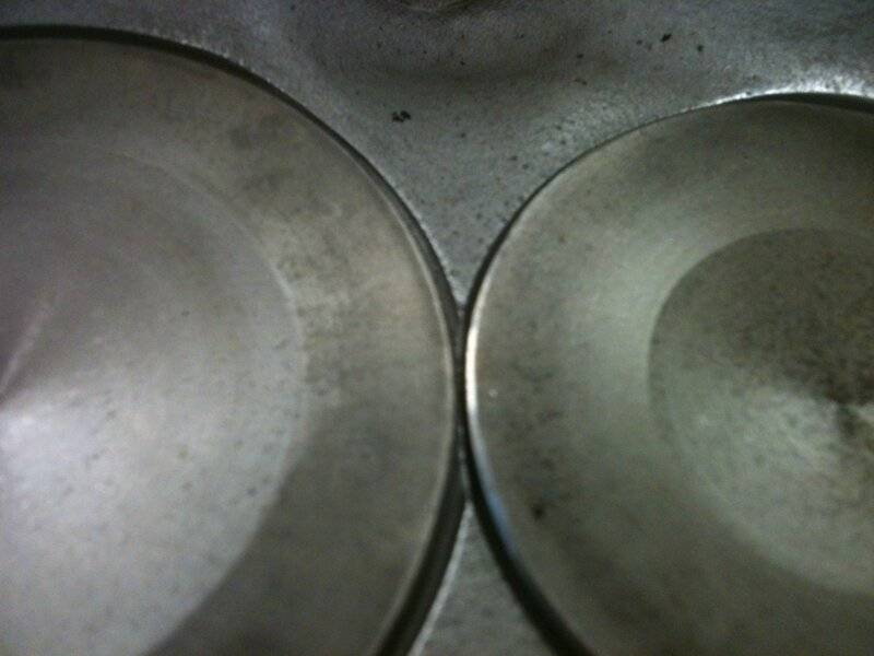

But...... not only were the valves too long, they were too big around and were clipping each other.

.050” between them is plenty.

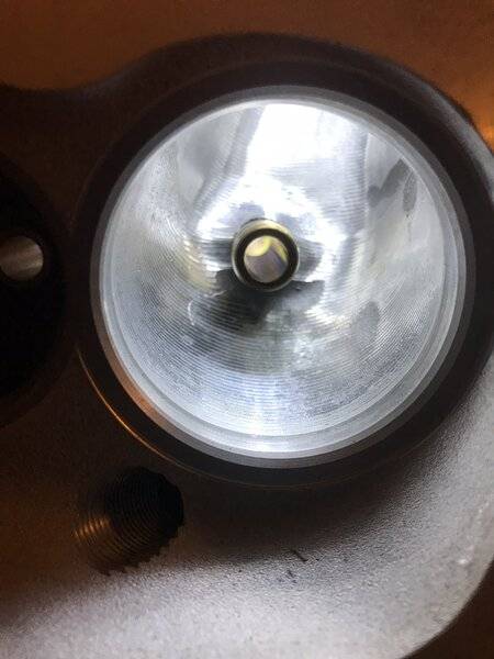

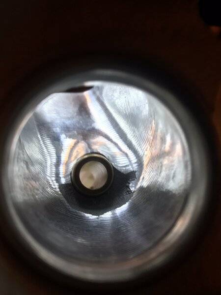

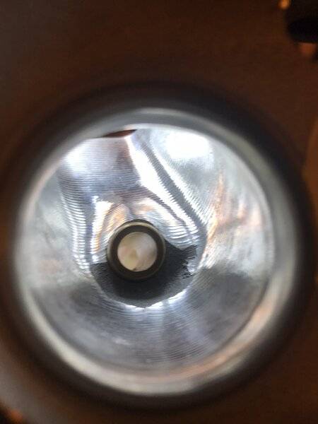

The ones I had here with the 1.88/2.25’s..... they were more like .005”-.010” apart.

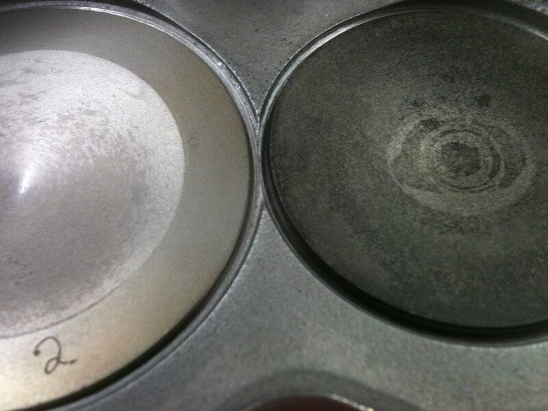

1.88/2.25:
1.81/2.20:

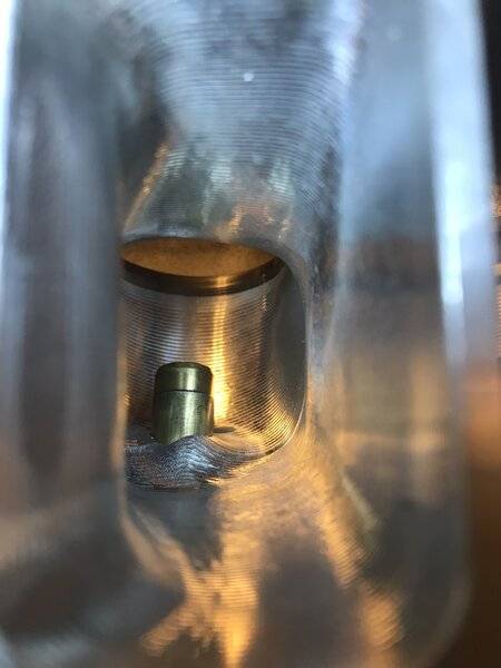

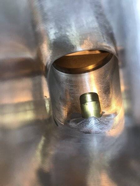

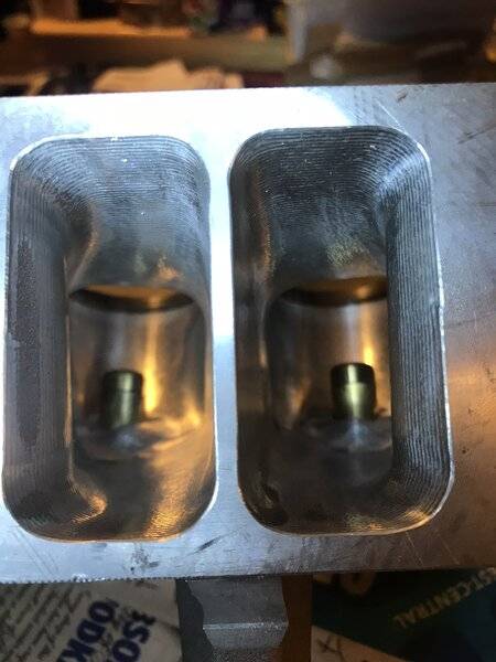

Kimmers intake port openings look bigger than the one set of cnc ported SM Victors I had here.
Are those MW size?
