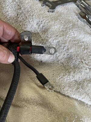

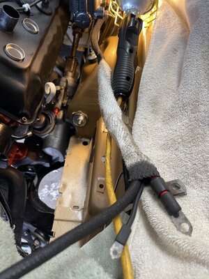

I'm trying to install my starter wiring harness today and I'm finding it difficult to connect the wires to the starter by going around the exhaust manifold from the bottom. So my question is how do I placed the wires in such a way that they can be connected to the starter. Do they go through the manifold? Anyone have any pictures you could send to me. That would be helpful.Also I need to know where the battery cable wire clamp should be fastened to?

66 has a hook on back of cylinder head. Goes around the back of exhaust manifold.
Around the back of the manifold per Bold &Old’s photo. A clip on the back of the head keeps it from sagging down onto the exhaust manifold.
That clip looks like the one on fender panel near rear adjustment cam. The hook on back of head, your hook maybe the short one, there are two. Hard to see but bolt on back cylinder head orange line to battery cable. Beat me, rats. This is a 71 hemi.
Don't know if you can put bolt in head without moving forward some in the car? I quit quick on mine.

That's a good shot of the wire loom going to the starter and that is what I figured it would have to be, especially with the exhaust flange connecting to the exhaust manifold right there. A big thank you for taking that photo.
