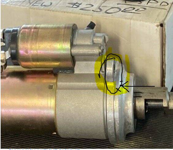

I'm not expert but a friend with a 4 speed car. He said there a small difference in the nose casting on Hemi starters. A little grind/machining MIGHT work. I'd buy the $320 starter and keep an eye open for a reasonable original. On that $320 starter no returns, I contact him through ebay and ask if he guarantees that it will fit. I'll check my garage for a starter that looks similar to a Hemi starter, think it's a 6 cylinder starter.
More from the memory bank. I believe you are correct, the truck starter requires a slight grinder massage on the nose to fit.

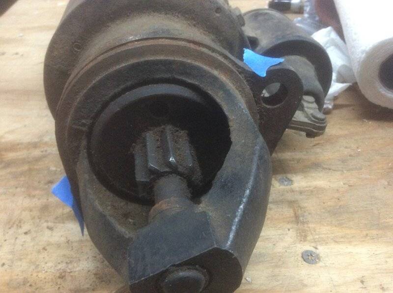

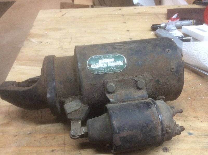

Hear is the starter I have. No clue if it works. The blue on right, I believe it needs to be ground there. Look at the picture of the $320 starter I circled ans a half *** arrow where it is clearanced. If your interested and if I can ship it in a flat rate box $25.

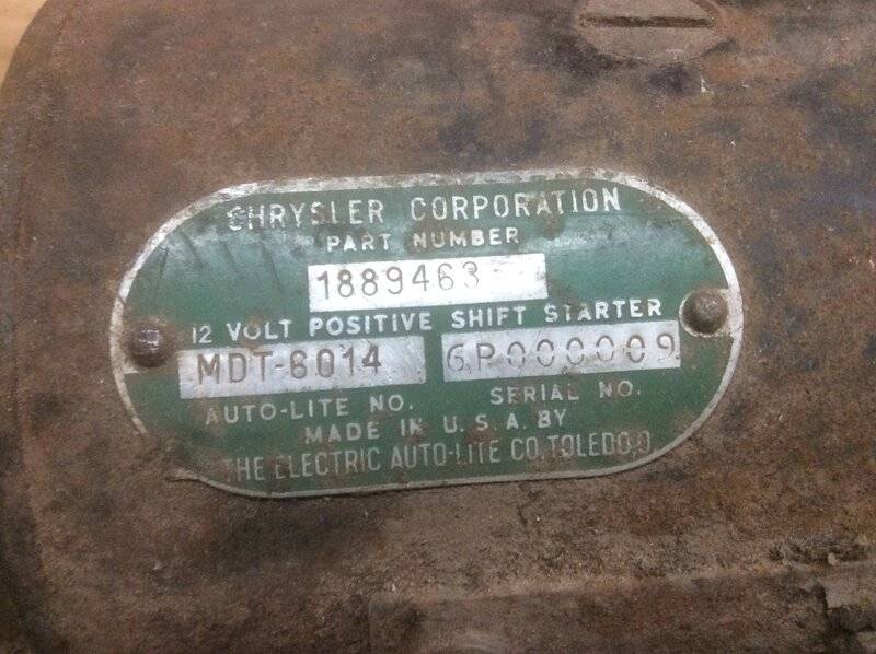

Of note, I seem to remember from eons ago, that the starter from certain Dodge 413 cu in truck engines are interchangeable. That may give a more reasonable priced path and may very well be what that Ebay starter with the 18****** part number is. Also of note, about 10 years ago, the smoke leaked out of the solenoid on mine and I was able to order a replacement from the dealer, for a 413 truck starter. It was the same.
