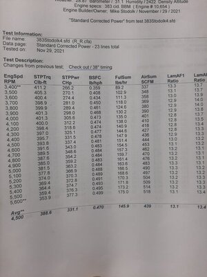

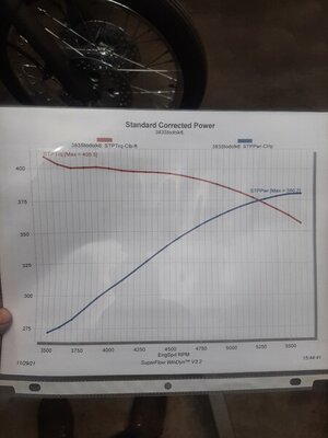

Stock cast intake and a 750 holley it made 380hp at 5600 and 408 tq at the beginning of the pull which was 3500. May have made more under 3500, but we didn't start the pull lower. Im pretty surprised actually. Just a bunch of old crap I had laying around.

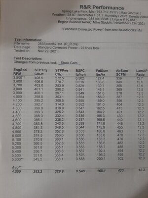

Also with the factory avs it lost around 12 hp.
Graph, and the sheet with the stock AVS numbers.

That's a nice build, and you're at least down twenty using the OEM cast-iron intake manifold. Great truck or street engine.

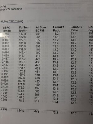

Some of the differences in power, comparing the AVS to the Holley, could be in the tune. Looking at the dynograph, the operator ran the Holley fairly lean, up to 13.4:1 at peak, compared to the 12.3:1 at peak with the AVS. Compare the fuel flow as well between the two carburetors. Lots of great data here to go through, other than just the peak output.
Overall, you're using less fuel, and making more power with the Holley, and that's a great spot to be in. Although on the street, I would richen it up to 12.5 - 12.8 AFR, just simple jetting changes, you're real close with that fuel curve.

Yeah, we saw that but I didn't feel like playing with it. I also ran a 750 4779. The af was similar and made similar power to the 750 hp. The AVS was rich for some reason. It's an all stock carb too.
