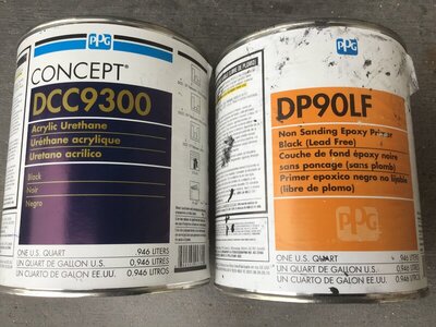

I like to paint with these products. Catalyzed urethane enamel. May be more durable than a rattle can.
Painting over rust is just a shortcut.
in my opinion, the only reason to NOT use epoxy primer is
A) painting over rust, or untreated rust (not that I trust "treated" rust); although I would trust epoxy over rust more than any of the "miracle products"
B) you don't want to shell out for a "quantity" of epoxy and activator; because you only need a small amount
