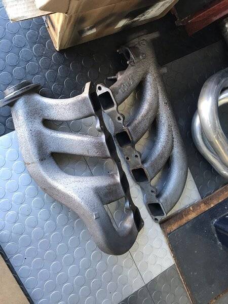

My Hemi manifolds were starting to show rust through whatever coating was put on them. I thought about putting them in my blast cabinet but it’s a medium sized unit and the Hemi manifolds are so big and heavy that it would have been difficult to get them done 100%. Plus I usually wheel it outside and hook it up to a shop vac and the weather has not been real cooperative lately. So I took the easy way out and got out my old standby - some good old navel jelly (now sold by Locktite) and gave them about three treatments of it. They came out looking pretty good since it was mostly just surface rust - it it also stripped the old paint off. We’ll see over time if it holds up. A little bit of surface staining left. This was before paint.

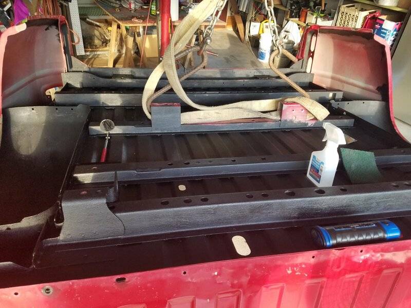

Another thing where there’s a 100 different products to use. Buddy who likes to give me his stout advice loves por15 telling me I just gotta use this on my replacement truck box last summer. The box was pretty nice; very little rust with most of the surfaces still with good primer and paint on it.
Did a long-long search on possible products to use and told him of the reviews I found about problems with por15 on coated or non-rusted surfaces peeling off. Didn’t believe me, lol. I selected two products I used after sanding down all of the surfaces to be coated. Time will tell how the stuff I used for rust protection will hold up..
