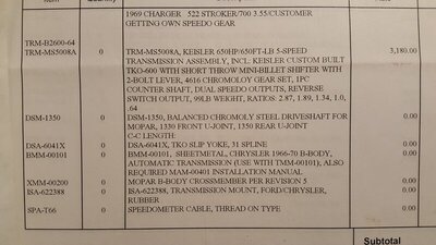

I have a 69 Charger. Came with 318/auto and I am not concerned about changing that. I bought it 2 years ago as a dis-assembled project with lots of parts. Here's my question; I have a new Keisler/Tremec 5 speed and most of the parts to install it, including new lakewood scattershield, flywheel, clutch, pressure plate, hydraulic clutch set up, shifter etc. I will need a driveshaft. I have read stories all over the map with these transmissions and since I have no experience with them I'm asking for thoughts good or bad. One of the things I'm not sure about is having read some models of these require cutting the torsion bar support ( I'm not doing that). This is also an early trans purchased 12/05 although has never been installed. Not sure if the trans built back then give trouble / won't shift etc. It is also the high hp model, paperwork says 650HP/650FT-LB. I have a stroker 440 that is my planned engine. Not built yet but should make 500+. I have experience with building motors having drag raced in my early days. Are these early Keislers problematic or not? I don't mind cutting the floor, do mind cutting anything else. thanks, Pat
Here's the trans in question

Build/delivery date? Early versions problematic 2-3 higher rpm and speedo cable and other leaks.

Thank for the input everyone. So it sounds like I should bolt the setup together and mock it up to determine if driveshaft angle is a problem and any other clearance issues. I'm not terribly concerned about high rpm shifts as I don't expect to be running down the drag strip with it. just want dependable performance with minimal cutting to the car and the occasional blast up through the gears. Build date as I stated 2005, delivered 12/05

Got it, and fortunately the PO saved all the paperwork. Thanks.
