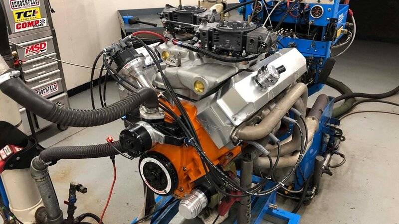

pretty impressive numbers for an intake considered to be a bottleneck. the term "max wedge" takes on a whole new meaning..
511-Inch Mopar Wedge Hits the Dyno and Makes Over 700 hp and Even More Torque! (motortrend.com)
My little 496 w a relatively mild, no lope, hydraulic roller cam, 10.2:1 w aluminum heads, Edelbrock Performer RPM dual plane intake made 610/670 hp/tq at the crank. HP came in at 5,200rpm. So a "built" 511", should be pretty easy to get 700.
They didn't say if it was a stock or aftermarket block.
Sounds like strong 440 4bbl numbers.

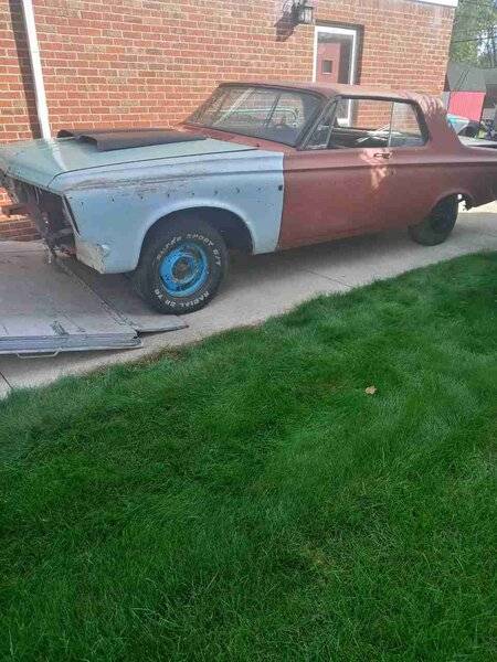

Nice build as I will be building one similar eventually for my 63 Plymouth project car.

same here,,mines identical to that 1 except for the compression, stock block build above. mines 10.7 - 1 comp. almost identical cam and A&A intake. but using 650 avs 2's..
plenty of pump gas motors making almost the same power. and i bet that 1 would be real close at 11-1...But the real story here is the stock TF 270's with the stock style Crossram making 728 HP ! before this dyno run last year if u got 650 HP out of your crossram u were doing good..

again, look at the intake used. A&A intakes combined with TF 270 heads or something similar appartantly works really well together. my shortblocks done, A&A intake on the bench, TF 270's arriving in 2 weeks !

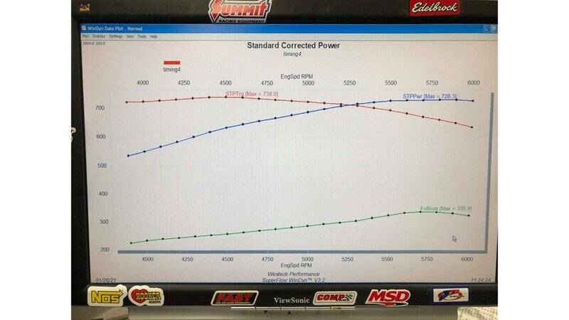

Though they look great, the cork is the intake. Years ago I dynoed a similar combo 4.375x4.150. similar cam 12.8-1, unported out of the box -1 Indys. The Indy 440-25 cross ram was worth 60HP over the factory cross ram. Factory cross ram peaked at 5750. Indy peaked at 6750. Power was up from the start of the pull (4000rpm) all the way to peak.

looks like with 350 cfm heads and a redesigned modern crossram from A&A and modern profile roller cam they upped the numbers a little bit..Big numbers for a stock "style" crossram.

After break-in, the dyno tuning began, and Brul found the sweet spot to be 36 degrees of timing. The best pull was 728 hp at 5,900 rpm and a whopping 738 lb-ft at 4,500! What's more impressive than the peak numbers are the crazy flat-as-a-proverbial-pancake torque numbers. The 511 rolls into the dyno making 719 lb-ft at 3,900 rpm and doesn't drop below 700 until 5,400 rpm! Even at the end of the pull it was still making well over 600 lb-ft of twist.
