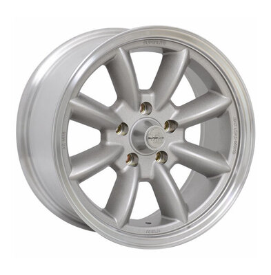

Have a 69 superbee with suspension upgrades. Upgrades are more aimed at handling than drag. Full hotchkis TVS plus a bunch of other goodies.
Right now I run
15x7 4.25bs 235/60R15 front
15x8 4.5bs 275/60R15 rear
Looking to get into a better handling tire but don’t want to go to 18s. I do like the classic look but 15” tire options suck.
The wheels I have chose come in 17x8 with 4.5 bs or 17x9.5 with 5.5 bs.
My top available size for the rear is 285/40r17 on the 17x9.5 rim. I was thinking the front would be 245/45r17 on the 17x8 wheel
But now I’m wondering if I could do a 275/40r17 on front with the 17x9.5?
I would love to hear your guys opinions and thoughts as well as pictures of your set ups with tire sizes. No 18”s!! 17” only.

I really like that wheel, a little pricey in a 17 last I looked. I have the same 15” set up you have currently with redline tires . When I change I want to go 17” and a wheel like this .
