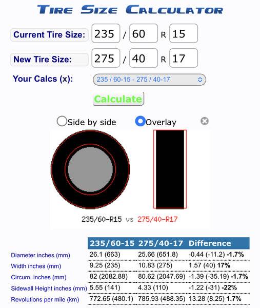

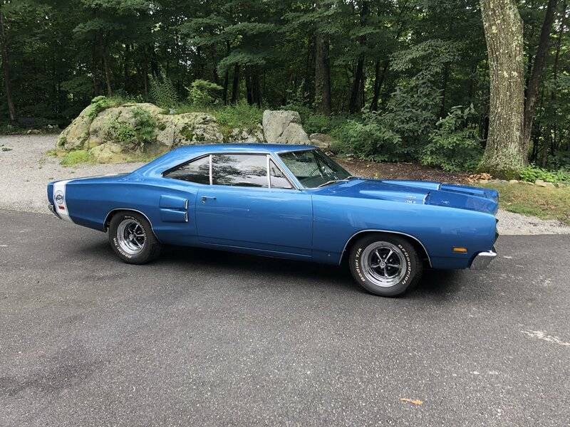

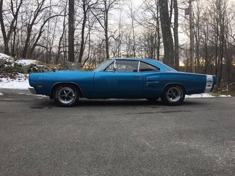

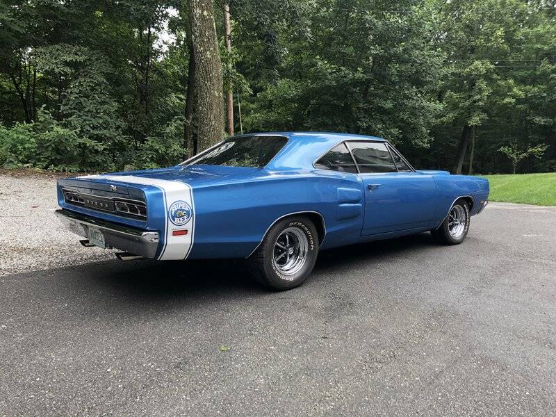

Have a 69 superbee with suspension upgrades. Upgrades are more aimed at handling than drag. Full hotchkis TVS plus a bunch of other goodies.
Right now I run
15x7 4.25bs 235/60R15 front
15x8 4.5bs 275/60R15 rear
Looking to get into a better handling tire but don’t want to go to 18s. I do like the classic look but 15” tire options suck.

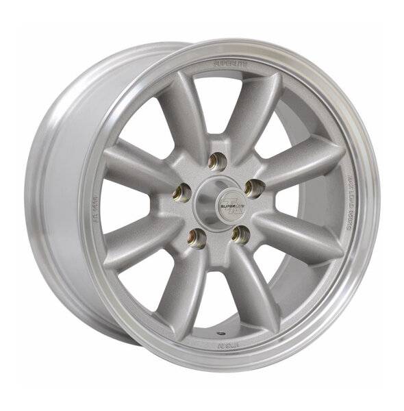

The wheels I have chose come in 17x8 with 4.5 bs or 17x9.5 with 5.5 bs.

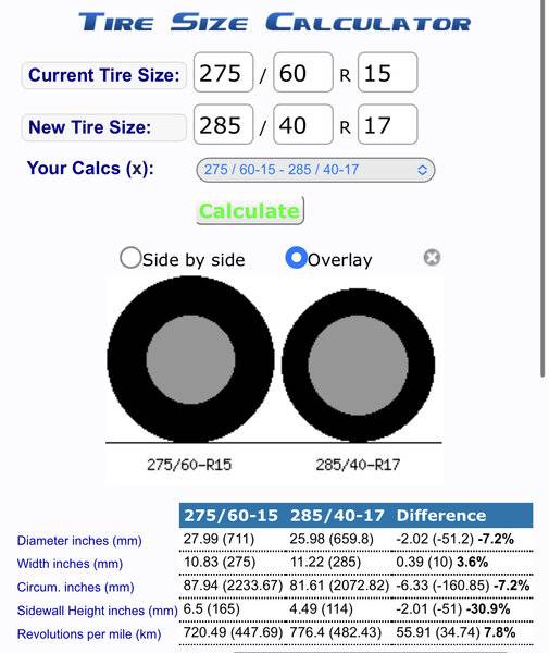

My top available size for the rear is 285/40r17 on the 17x9.5 rim. I was thinking the front would be 245/45r17 on the 17x8 wheel
But now I’m wondering if I could do a 275/40r17 on front with the 17x9.5?
I would love to hear your guys opinions and thoughts as well as pictures of your set ups with tire sizes. No 18”s!! 17” only.

I really like that wheel, a little pricey in a 17 last I looked. I have the same 15” set up you have currently with redline tires . When I change I want to go 17” and a wheel like this .
your car looks great in the photos above!

Well, you have captured the dilemma. Sidewalls and overall tire diameter options shrink when you jump up from 15" to 16-17-18 inch wheels, and the larger Mopars like this need a tall tire with sidewall in the rear to look "right". The tallest tires you'll find in 17" will be around 26" tall, while the commonly used 275-60-15 rear tire is 28". To gain some of the performance you are looking for you will have to sacrifice the old-school muscle look a bit. You can compensate by lowering the car which disguises the shorter tires a somewhat. That will also tend to help the handling performance you want.
I have serious doubts that you will be able to put 275/40r17 on front with the 17x9.5 without rub.
I'm using 16x8 255/50/16 all around on one of my cars which is a 26" tire. It has decent sidewall exposed but handles much better as a max-summer-perf, soft tread tire.
Yea you got it. Have been on tire calculators and searching tires online for a week now and feel like what I really want just isn’t going to happen. The car is lowered already.( believe hotchkis leafs drop it an inch or two) I’m pushing width trying to get more diameter out of 40 or 45 series tires. I did also find a 305/45/17 but it is a 555rii Nitto drag radial. They say it does have more of a street tire sidewall but I don’t know if it will end up handling like the 15s and I don’t even know if they will fit width wise.

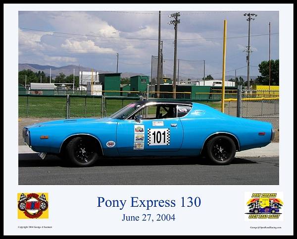

I went 15's to 17's for my 70 fury and have used on my charger as well, they make a big difference in handling.
