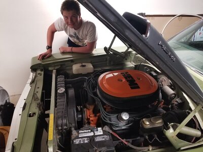

SO, I recently bought a 1969 Superbee with a 426 Hemi, but it turns out the engine was once set up at 13:1 Compression. However, it has since been sleeved so that it's now 10.5 to 1.
I'm still working on getting the car all back up to speed (mechanically), but my question is "Does anyone here know (or have a history of trying to run) what Octane Level I'll probably need to run it?" Back when I though it was 10.1/4 to 1, I was optimistic that I "might" get away with 91 Octane pump gas, but now I'm not so sure that's even in the cards. Also, as a side note, are certain brands of 91 Octane closer to actually being 91 Octane than other brands? Thanks for any insight you guys can provide. -Cheers
(P.S. that's not me, ...it's my 14 year old kid, salivating.)
