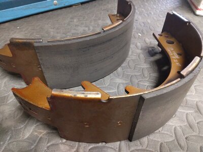

If you have drum brakes and have serviced the brakes and replaced many parts including the brake shoes and now your drum brakes drag and lock up when turning in forward direction but release when turning in the opposite direction the problem are your brand new brake shoes! The primary shoe has the shorter brake lining material and many new brake shoes are coming with that front lining not centered but much lower on the brake shoe (see pic). Many reputable companies are putting out these brake shoes probably because they are all being imported from the same factory in China. And therefore have the front lining off center. After reading many forums at 'b-bodiesonly' and having many well intentioned participants giving out the same wrong information and changing many parts including wheel cylinders..master cylinder..even the power brake booster and trying out multiple return spring combinations thinking that they weren't strong enough to pull the shoes back, the problem would not go away. The brakes continued to self generate when rotated in the forward direction and lock up but functioned normally in the reverse direction. The solution is to look at the photos closely and replace your brake shoes with ones that have the lining material in the center. (see 2nd and 3rd pics). The problem is that the top edge of the off centered lining is getting caught on the brake drum when the brakes are applied and causing the shoes to self generate which is clearly visible by watching the star adjuster move aft as the drum catches the leading edge of the front shoe and starts to self generate causing the wheel to lock up. Change the brake shoes with ones that the linings are centered and your problem is solved.

Would aggressively chamfering the edge of the linings help any?

I've had a related issue with drum brakes locking up on me with only the slightest touch of the brake pedal. Chamfering the width edge of the shoes corrected the problem for me. The edge of the shoe material was contacting the drum first causing the issue.
I’ll look at some of my old shoes (1970s) I’m almost sure they are all made that way. Maybe the problem is the new ones are just made too short on the top edge. Old ones are both equal on bottom not raised like in your pic, I’m thinking the lining should be up to that notch
I spent nearly 3 weeks finding my similar problem. The lining on the new shoes was also too far around the shoes but also the rub blocks were in the wrong place and smaller. The shoes were rolling over backing plate edge and hanging up there. I also changed springs and cylinder without success and only when comparing original shoes to replacement parts found the defects. Improper shoes were Spectra and found right shoes at Canadian Tire. Will post photos when I find them(lost in my computer).

I purchased what appears to be the last Wagner OE Spec CR169 from a Canadian Tire store. They no longer show them available. My grabbing brake was only on the front right, it got worse with each brake application but went away when backing up. It created a lot of heat as it was dragging but did not seem to cause pull to the right except when brakes applied. The location of the lining on the primary shoe along with the small rub pad on the shoe and 60 years of wear on the backing plate probably all contributed to the drastic wheel lock. The first set of shoes I installed were from Wrench Monkey, Canadian version of Rock Auto, they were Raybestos 169PG. They were separating and cracking at the rivets and were changed by a brake shop who were doing safety inspection for gov't so I could register the car,held prisoner till safe to drive. They then put in the Perfect Stop and did mention car pulled slightly but would not hinder driving, it did work well enough to drive out of shop and hand over to me. Called this shop to report what was happening and basically told so what. Buying auto parts on line is hazardous as you can't compare and displayed item is usually generic, I now try to source from local distributors and take old part with me. I try to avoid anything made in China but hard to do.
