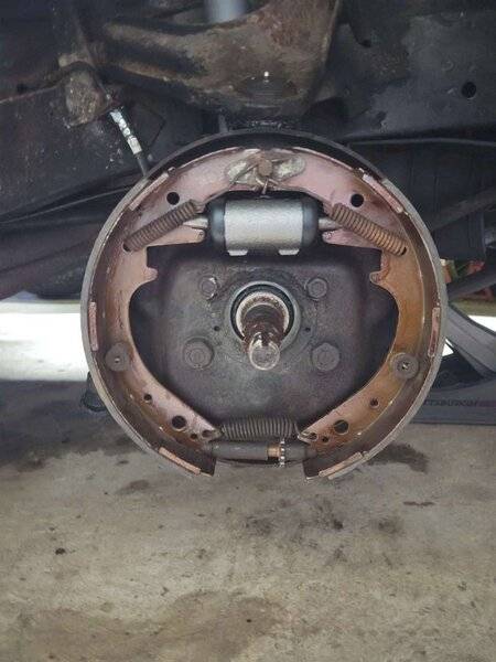

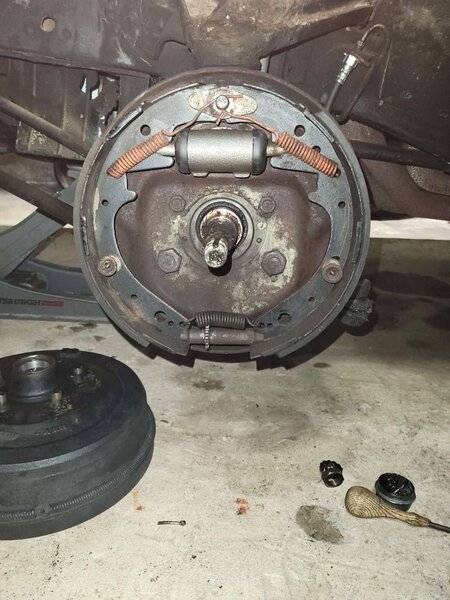

First image is passenger side.

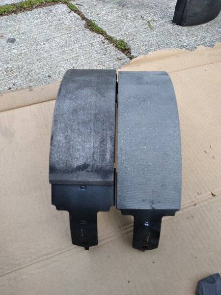

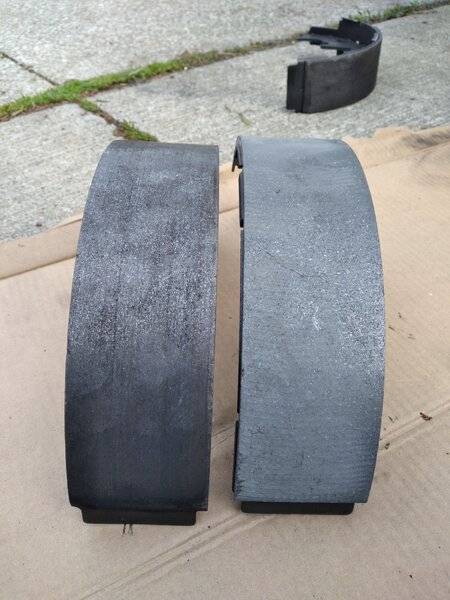

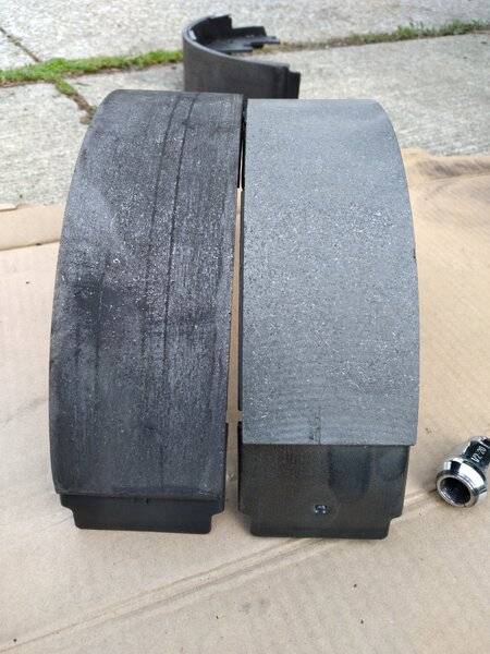

1st image on the passenger side you have 2 rear shoes on it.
2nd image on the drivers side has the correct setup. 1 front ( short pad ) & 1 rear ( longer pad )
Look at the pad length between the 2
It does make a difference.

I was kind of thinking the same thing. Will jack up the rear and find the missing front right shoe tomorrow. Will replace fronts with new!

Also what are the diameters of your drums. They need to be relatively the same side to side and not beyond minimum service specifications. Both of your rear brakes also need to be 100 percent.

I think the O'Reilly shoes fixed the problem. Not locking up on the drivers side anymore.
