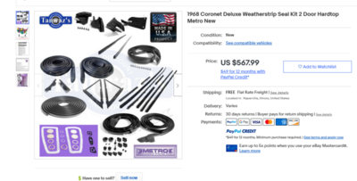

Yes sir, it's going to be a difficult task for sure. I did notice that they labeled the window mechs with "R/L" but figuring out just exactly how they go in will be another ballgame. They also labeled the little weatherstripping pieces of where they go too but we'll be ordering those new, which I believe this link is the correct kit we'll need(someone correct me if I'm wrong on that before I waste $568 on the wrong kit): https://www.ebay.com/itm/1968-Coron...eal-Kit-2-Door-Hardtop-Metro-New/392563515082
It's got my dad excited about getting to do a Mopar and drive it when it's done so that'll be worth it to me to go through all the undoubtedly future headaches. He's had a few Mopars back in the day when he could get them for just a couple hundred bucks like a Demon, Goat, Belvedere, and I think a '67 Charger (can't remember the exact years off the top of my head but he knows)
Looks correct to me. If you want good info look for @dadsbee build info that man did an amazing job recording the build with lots of information and photos.

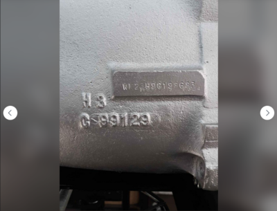

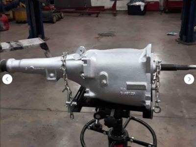

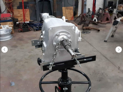

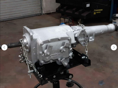

Before I screw up and travel 450 miles round trip, will this A833 work for my ride? Signs are pointing to no from what I've gathered regardless of what the guy said so I'm needing a second opinion(fact) from an expert, thanks.
No....
...what you need..
Thanks, @dadsbee . I just changed my search parameters and actually found the exact same guy we were going to meet and it's $100 cheaper than the one I posted above! Holy ****, talk about lucking out. You've got a hell of a build by the way. I'm on page 7 of your '69 build thread and I'm highly impressed with your work.
