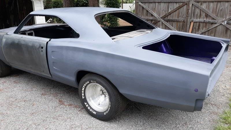

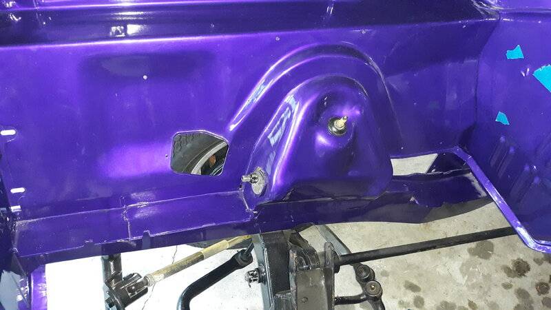

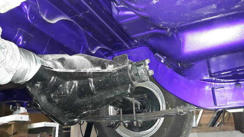

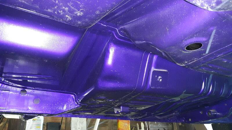

Current condition after a wipedown.

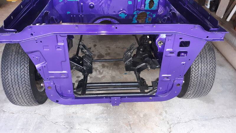

Front end buttoned up, tightened down but not torqued.

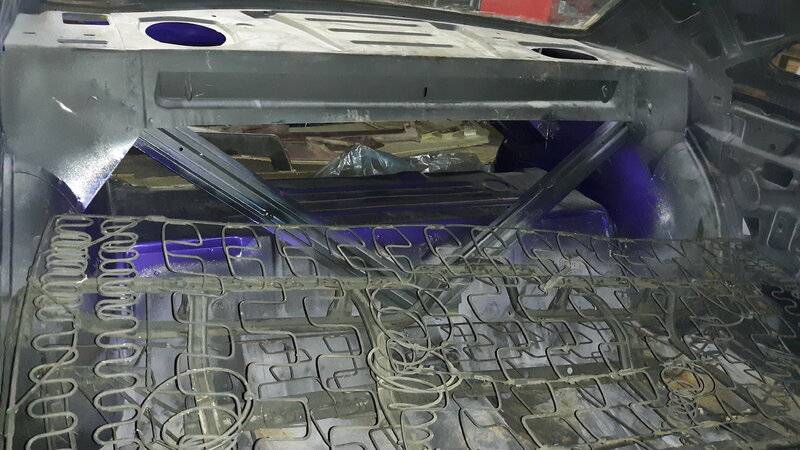

Dad started to feather in the quarters where the Hot Shop left off in '06 and I'll be taking over the rest.
Some hammer & dolly work needed on roof still.
Body in decent shape.
Trunk, surprisingly, needs very little patch work.
Got the doors gaps pretty damn close and they close smoothly.

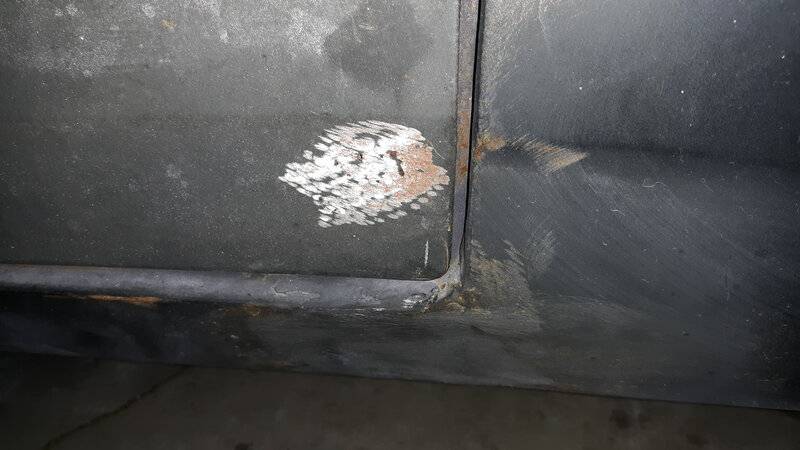

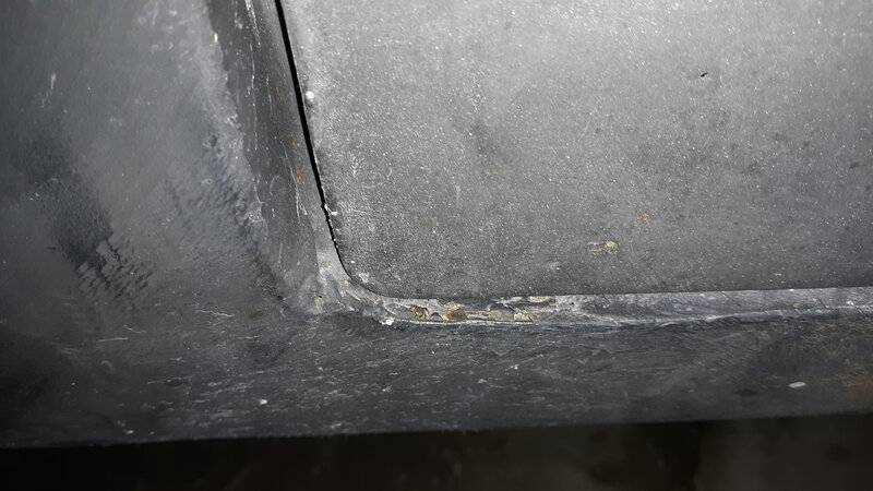

Small area on driver door needs welded up and lower door jamb area on both in the rear corners.
Plan is to tackle the body work, get the fenders on(one needs a lower patch),prime, block and sand 3x or 4x then go after the interior.

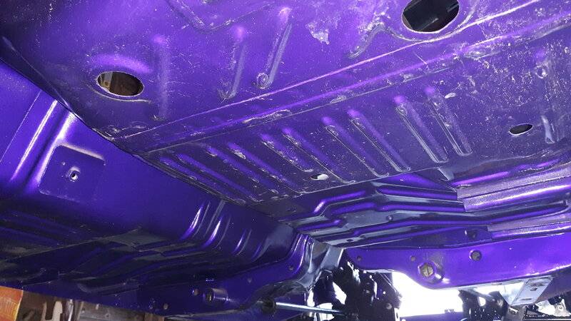

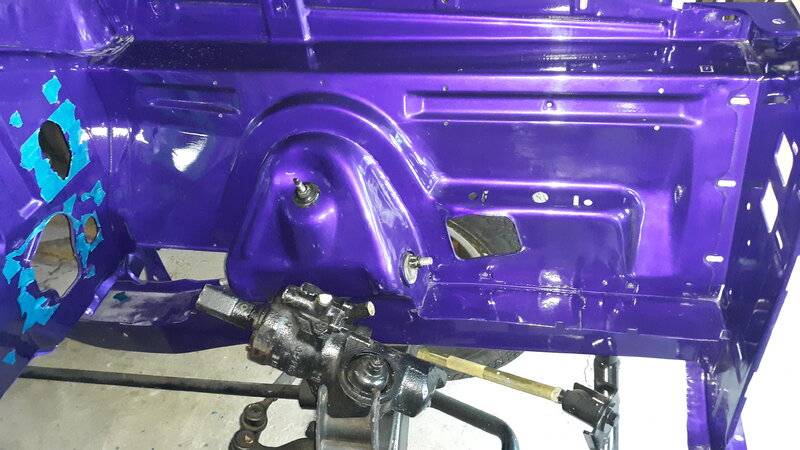

Not permanent. It's in epoxy black primer now and if the budget comes in, we're probably just going to go ahead and paint the whole car plumb crazy purple to match the underside.

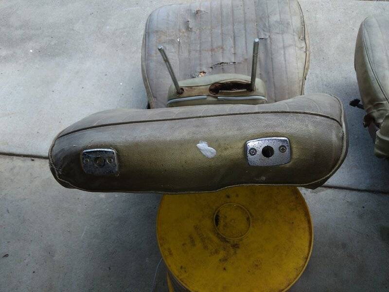

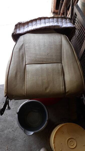

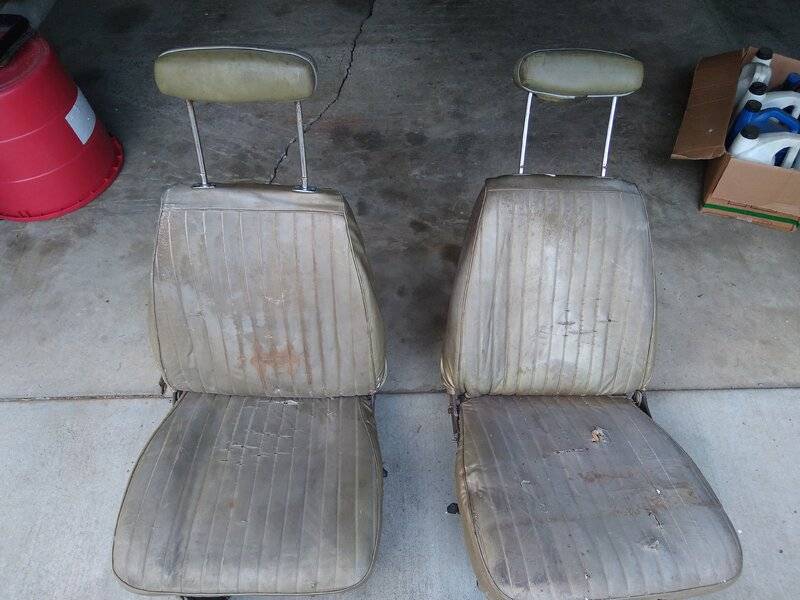

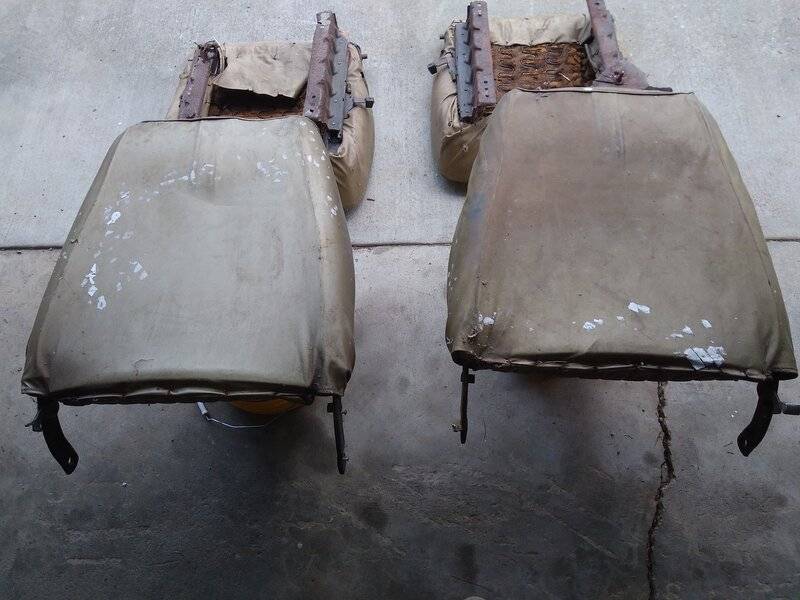

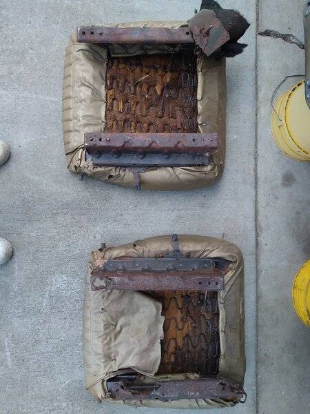

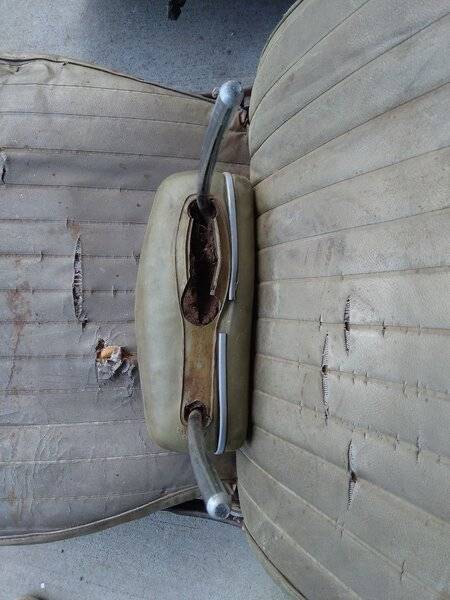

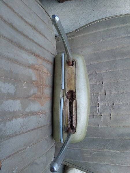

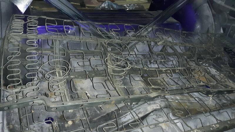

Something is off with my seats and the new covers that came with the car. I know they're not what came in the car originally as it was the red/white interior and these seats are a goldish color. The gold ones are a solid piece and the new covers are open back. So either I'm going to just trade the seats for a split bench, which would be original to the car, or I'm going to have to get the right seat covers in white for these frames. The mount bottoms are pretty roached but the springs and everything else seems fine. I've got better seat mounts that look identical we'll be using too or can be in the swap.
lmao mystery solved..seems like someone had the sense to put a cover over the original upholstery to these seats and what I have will work

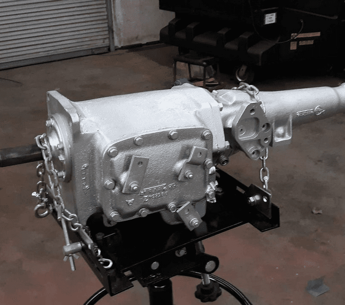

got our trans couple weeks ago - freshly rebuilt 23 spline a833 for a deal (guy who rebuilt it has a sweet charger and challenger, both top notch rides)

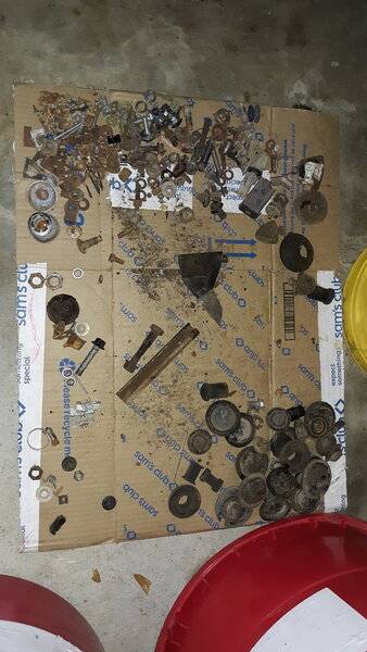

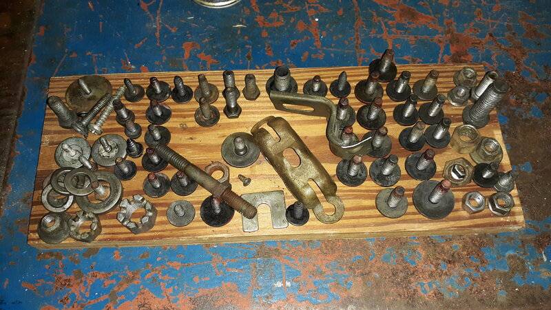

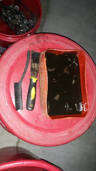

going through all the hardware and cleaning them up (evaporust is your friend - just too bad it can't make my life's problems disappear like the rust and grime)

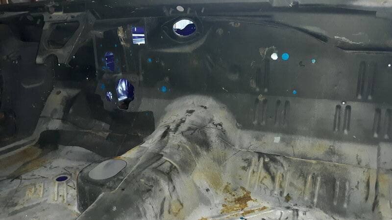

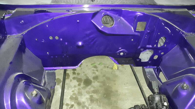

16-17 year old painter's tape removed from firewall ( heat gun and plastic trim/clip removal tools SLOWLY and GENTLY)

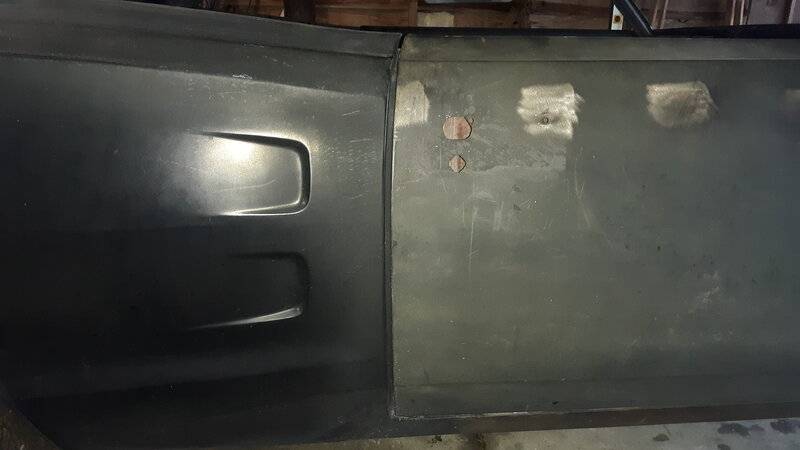

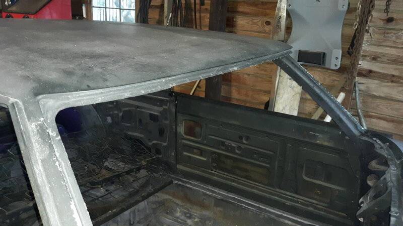

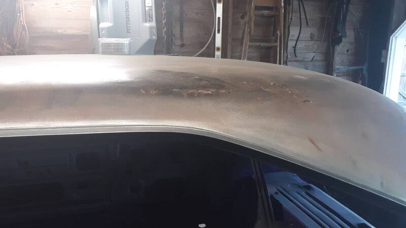

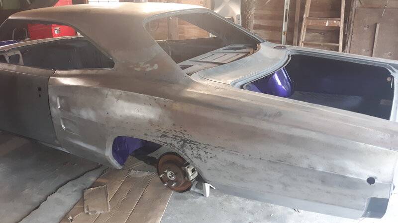

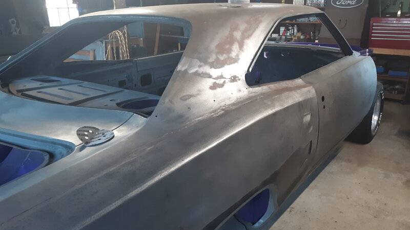

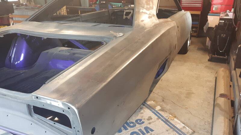

sanding, sanding, sanding, hammer and dolly, heat shrinking stretched area in roof, sanding, and some more sanding 10+ year old epoxy primer off to put fresh on
one little spot in the roof that's giving me a tough time, quarter welds were flap disc grounded good enough for glass

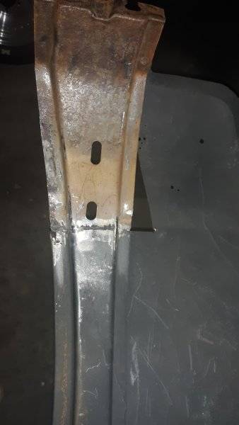

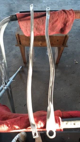

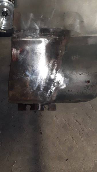

got an original lower fender brace cut and mailed from oregon after some searching around and the passenger fender patched a couple weeks ago
just got done blasting then wire brushing the wiper arms and pivots, going to leave them bare metal and brush with rpm when i pick some up

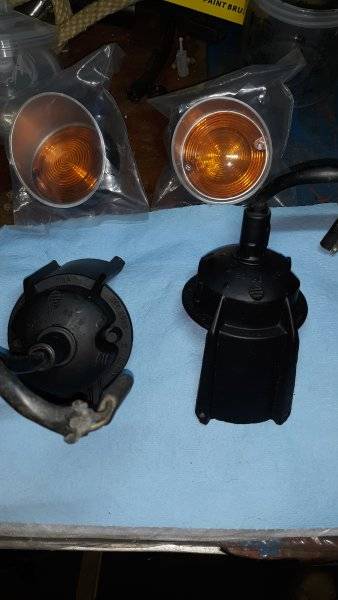

blasted the park light housings and painted - got new lenses as one of our originals has a bb sized holed in it

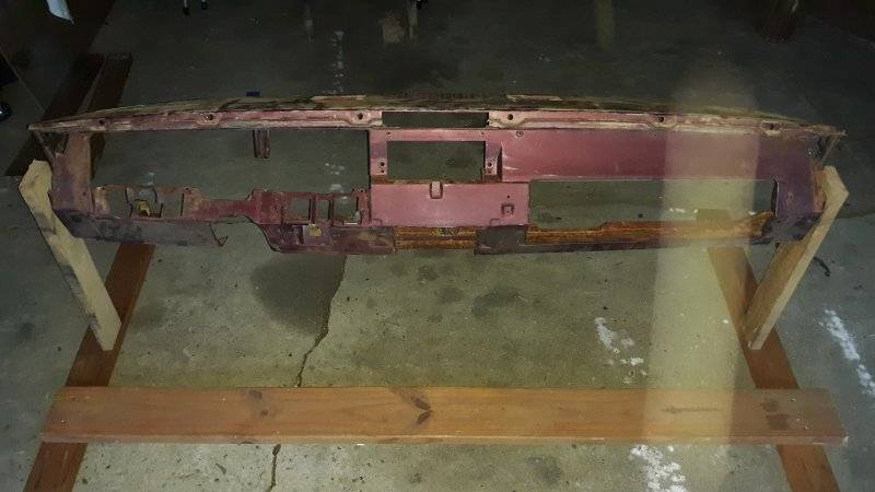

mocked up the dash to blast on a jig i made then our blast gun crapped out (2nd one from harbor freight - will be getting an eastwood one next and converting our cabinet to a foot operated blaster)

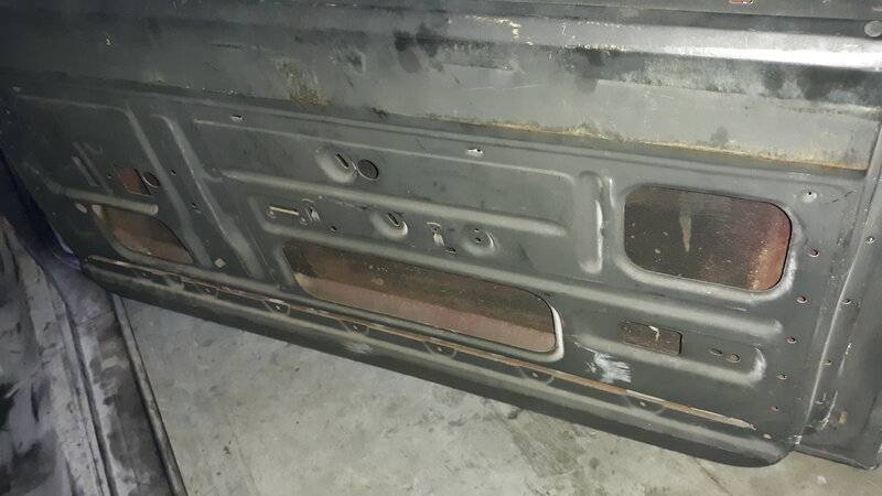

got the main body in epoxy primer

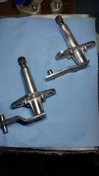

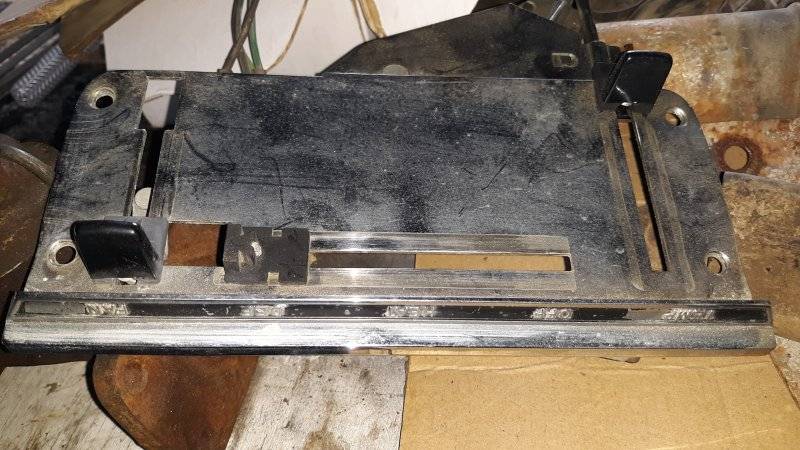

got the heater mech that mopar john hooked me up with cleaned and polished today with some polish cream i already had for wheels
used wd-40 and blue shop towels to clean off the bulk of the dirt/grime and armor all for the slider knobs
although they're both 1968 heater mechanisms, noticed that the one original to our car has a smooth underside and the one i cleaned has a textured/rough underside (maybe different model that year?)
so i may just have to clean our original up although i kind of like the textured look better
