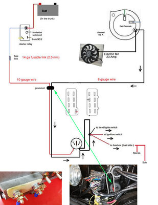

This is not something you HAVE to do but just remember there is always a risk of melting the bulkhead connector somewhere in the future. So take it for what it is. The volt gauge modification would be perfect for this MAD modification if you bypass the amp gauge. You could then use a volt meter instead of the amp gauge to know your voltage. Thus the need for the gauge modification.
Even with the new harness. I would suspect the entire load of the vehicle going through that spade connector in the bulk head connector is still a potential for melting the bulkhead block. Even doing the bolt the wires together thing still puts that load going through that spade connector. I often wondered why in the MAD drawings they didn't just drill out the bulkhead block and run the wire straight through and still retain the amp gauge. But now I see why in Drawing B.
They pretty much just bolt the wires together and bypass the amp gauge. Looking at the drawings below they show the power distribution is cut short from the alternator and it goes directly to the starter relay.
This is why they no longer use the amp gauge. You cut out the weak link which is the spade connector.
But the way the MAD drawing shows they do more than just pass the wire through the bulkhead connector. Here is a link to the MAD page on the Amp gauge. Perhaps they word it better than me.

If you look at drawing B they use fused links.. You can remove them at the starter relay. But the red and black wires won't be removable at the bulkhead connector. Since they tie into the black splice that feeds the fuse panel, light switch and ignition. You could remove the bolt where you tie the red and black together and pull the red into the engine side. But the black would be an issue.

Why can't you leave the stock wiring and amp.meter. Connected and just add a 10ga wire from the alt stud to the starter relay.
The alt will then still charge would it not ?
I have a question about this .
Yes it would. The Amp gauge would then be disabled.

I did it like this. (With new harness/connectors installed at the same time plus dielectric grease.)
