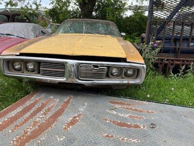

Bought this 1974 Charger a few months ago. 66k original miles. Has been sitting for a long time. A number of things are disconnected and apart. Front of the motor is apart. Fuel system is apart. Brakes go to the floor. All of it seems to be there. I just put in a new cam and lifters and am getting the motor buttoned up for a startup. Just recently found out that I've got a 4.10 posi (489 case)!

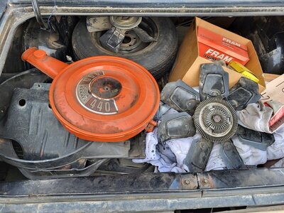

Nice. Even still has the rare factory air cleaner. Dang loaded!

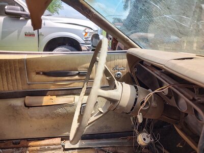

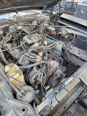

If you ever score some parts for a 73/74 keep me in mind, I'm dragging my not so complete find home on Monday/Tuesday..73 SE Brougham, but I'm gonna have to give her some love, car's too straight and too solid not to save

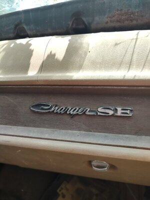

I'm curious if you can get the correct vinyl top material for the 73-4 SE's?
That's awesome. That material is a pretty big part of the SE package IMO, they just wouldn't look right with a different material.
