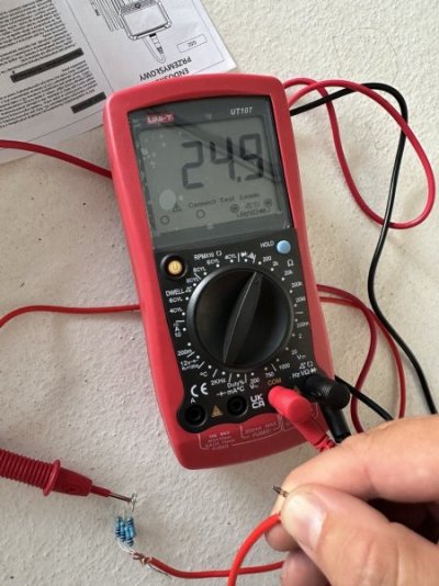

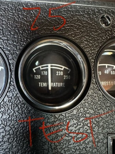

So I read that you can test gauge by feeding ohm to it. So I did and when feeding 25 ohms - gauge is reading in the middle. Which is correct. Also feed 10 omh and was reading full.

When I feed to gauge 25 ohms - it is showing proper half of temp gauge.

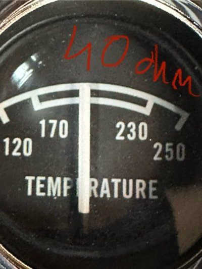

When sender is sending 40 ohms - it is showing center of temp gauge (should be like less than that)

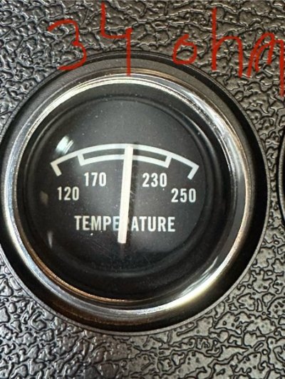

When sender is sending 34 ohms - its is showing MORE than half.
Why 25 ohms which I feed is showing less than 34 ohms from temp sender unity?!

I saw the 40 and 34 and resistance going down.. gauge went up. I'm not following how you are "feeding" resistance.
My gauge on the Bee is off so I added a mechanical gauge. Hope you get it figured out.
40 and 34 are read from sender - connected ohm meter read ohms and made photos of gauge
25 is feeded by connecting 4 resistors that create 25ohm reading into sender wire.
And you connected these resistors where? Between the sender terminal and wire connector or block ground and wire?
between sender plug and block ground / battery ground (same values)
