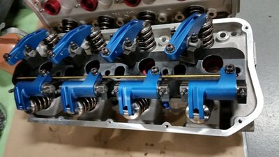

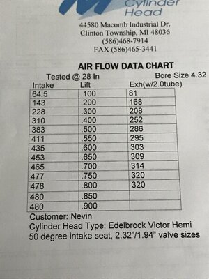

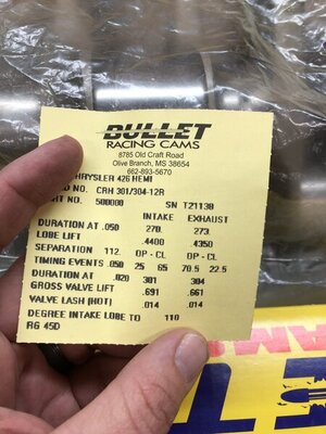

I think a stage V or even a ported edelbrock from modern will get it done on that size engine with your compression and the right cam. I’m shooting for 800 on mine. We will soon see. 548, 11:1 street build.

I now have the stage v heads from Tim Banning and they flow a little better than yours in the low lift, but not as good as yours at the upper lifts. The cam you have in your 548 looks like a very stout cam. How well does it run, any time slips?

not yet, I’m probably gonna dyno it. Haven’t decided if I’m running it with the cross ram or the barton single. Either way I have some grinding to do on an intake. Motor it’s self is ready.. I’ve been side tracked playing with my dads dart. Had it out at monster mopar over last weekend. It’s starting to come around.

I see you have a 3* split, like mine. 275/278@50-.725 on 110. Will be 11.7 or 12:1 depending on gasket. I have the stage V 2x4 intake, but am now looking at going Indy tunnel ram since that is what i currently have on my wedge street car. I really like T rams on the street. Working on the internal oiling system now. Thats a bit of a head scratcher, but i'm figuring it out with some help from the guys over on Moparts.
