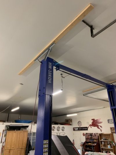

Didn't trust my floor with a relief cut very close to one post so I joined the post tops.

I have 12' 4" ceiling height, the top of the posts are 7" down from the ceiling. As others have said you want the cables going over the top to keep the floor clear.
It is a 10K and it is installed on a 4 inch thick slab. I put braces on the top to keep the posts from moving and possibly walking the anchor bolts out. I also went the extra mile and poured a thin anchoring epoxy around the bolts too. I put my Duramax diesel truck on it all the time, no problems at all after 3 1/2 years of constant use.
