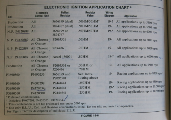

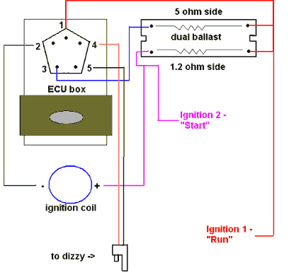

oK for the strip not the street. The .25 resistor is for the chrome and gold boxes only for the strip since they have cool down between runs Will over heat any box if used for a cruiser Question is how you going to drive it? Also why not points? The new orange boxes suck and either Authorized Mopar or Mopar approved. Still made cheaply. There is a whole thread on these on fabo. n which are real and not. Whatever box you get make sure it is from 2000 and back.

OK now dist. talk. You have to know what parts are in your engine then adjust a distributors curve to get it close. Yes any will make it run but run for your engine is a different thing. Most aftermarket ones have a really fast cure more set uo for the strip, Hope this helps you out.

Thanks for ur comments...
But this needs some clarifications.
Since originally we raced for Chrysler and had sponsorship we had direct communications with their tech staff.
The best info for their OE high performance ignition systems is archived in their Tech Bulletins.
Also note that in later years, Mopar went outside(mainly off-shore) for certain ignition components and their quality, reliability and
specs can/will vary from their original performance parameters. The other primary electrical point strongly emphasized by Mopar is to upgrade
the electrical system(alternator & regulator) to have at least 75 amp capability.
In my case, I still have a stash of original OE ignition components, and have been running the posted system for many years without any issues.
But I do carry some spares if they are needed.
Attached are a couple of page copies from the Tech Bulletins for ignition systems.
Just my $0.02... :thumbsup:
