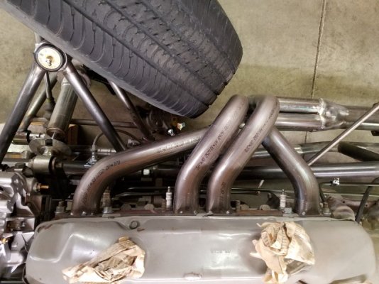

Why not a custom set?
Low cost and competitive quality.
These cost me $320.00.
Have a set on a Jeep CJ from the
same builder installed more than
20 years ago. Zero issues

Not everyone has a custom header shop nearby to have the headers fitted too, I don't. I'd be really surprised if they could build a set that cheap for a B Body, takes a lot more work to fit them in a B Body than a Jeep. Jeep looks very cool, nice.

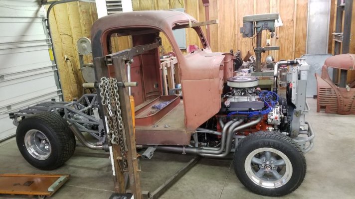

Headers on a Jeep is quite the project
given the space constraints are
limited to inside the frame and run
to the rear.
The set in the pics is on a 440 in a
1940 Plymouth truck. (custom tube
chassis).
PM me if you'd like a reputable source
for a custom built quality header.
Guaranteed he's run across B Body
builds before.
