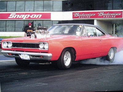

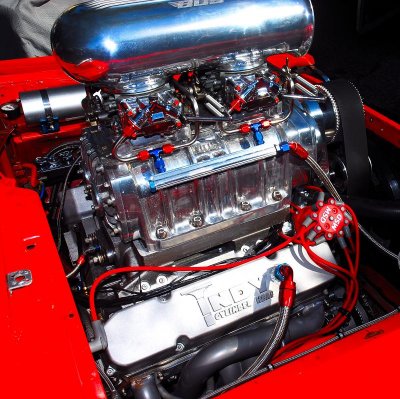

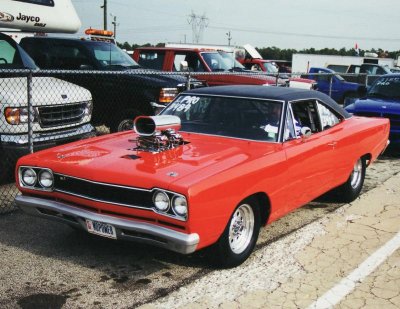

Hay purple FYI Evans has been documented to raise coolant Temps is some cases depending on the cooling system. I stated I'm currently running Evans in my 496 pump gas motor in my 67 GTX. Evans will not make your engine run cooler if your having issues with a cooling system, it non corrosive, no water means no Hot spot , boil overs, high pressure issues. I have a brand new cooling system on a fresh motor 180 stat. she runs right on the number in the heat of the summer. As far as a 871 goes ya I know a thing or two about them. peace.i10846.jpgDSC_0298.jpgPicture 551.jpgIMG.jpg
