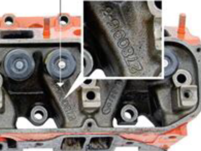

Is there different heads that came with 440 six pack are a 440 with a 4 barrel on it . Would it have bigger valves on the six pack over the 4 barrel ? And how would u tell the difference between the two . One would think that the six pack would have bigger valves than the 4 barrel. R there numbers on the heads to tell them apart? And some one had gave me a gift and I wanted to thank them .
Same heads within the same model year. Only difference from a 383 2bbl to a 440+6 is the valves & springs. Same exact head casting. Same valve size.
69-70 2843906
1971 3462346
So with this 440 beening a 1970 it should b 906. Where would the stamping b located at ? Under the valve covers ?
yep, under the valve covers. They could also be 452’s which are the same as 906’s but have hardened seats.They would’ve been changed tho, as 452 didn’t come out until 1973 I believe, but a popular change to get the hardened seats for unleaded has. Other possible heads are 516, 915, 346, and 250, which are all direct bolt on’s but have different sized valves and chamber designs.
Yes, the casting number is on top of the intake port. The '69 & 70 6 Pak motors will have 906 heads. My recollection is that the '71 6 Pak's may have had 906 or maybe 346,in a a few most likely 906. Valve size is the same.
