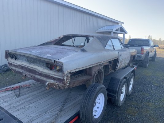

Does the full quarter, tail panel, and valance make the entire outside corner? Is there another part in there? I can not tell mine is pretty bad shape
on one side and the other side is missing.

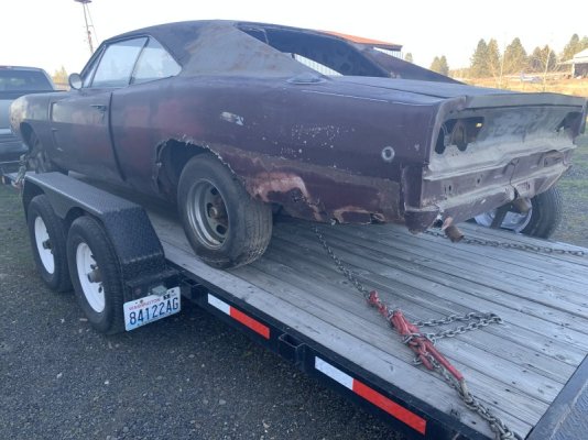

This is the car- it was posted for sale on here. Looks worse in person.
It has a daylight basement

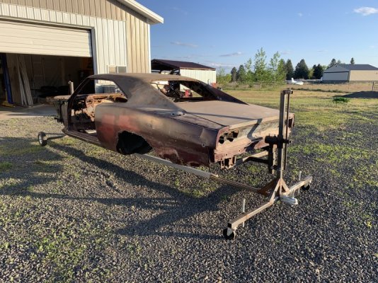

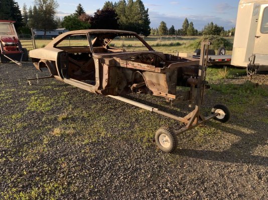

Got er all stripped down and put on the rotisserie, pulled it outside just as the sun set and it quit raining

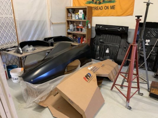

New panels and floors. They do a good job boxing the parts up, no damage found.
