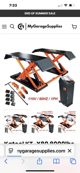

Well, i lost out on the Bendpak i initially asked about…. Now wondering if this Katool woukd work under a Charger…
Katool KT-X80 8000lbs Mid Rise Scissor LiftView attachment 1932049
I've been looking at those too. Seems optimal without all the bars in the center of it. I don't see how you could work under most of them.
I agree with you, however these are not ALI certified, so wont be spending my hard earned money this one….
Now looking at a Wheeltronics/Snap-On 6k scissors (used)…. I understand its factory IS ALI certified
