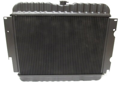

I got mine from a company on Ebay, painted black, the tanks look just like a stock original, sans part number. It works really well and fit nicely. It was around 280 delivered if I remember correctly. I went from overheating/running hot to cool as a breeze. I will look for a link and edit this post. Comes with hardware to mount the fan shroud and correctish brackets. I plan on putting this into my Coronet from the Belvedere, since the Coronet decided to start running hot.

I love that at a glance this looks factory.

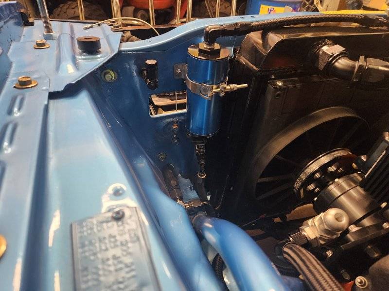

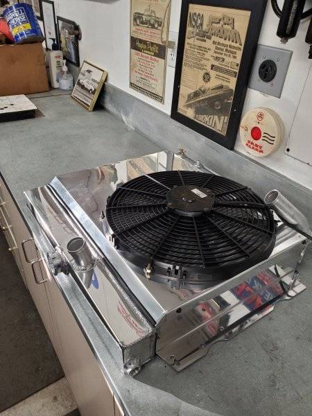

I had a custom aluminum radiator with dual electric fans built for my Challenger that I added -20 weld bungs to. With over 2-1/2 times the horsepower over stock and it runs cooler than any of my more milder cars. I had it out cruisin around yesterday all day at 90 degree outside and it ran at 167 degrees all day
It seems like your upper Rad hose does not allow much engine/motor mount movement. Is it on a motor plate or not a concen?
