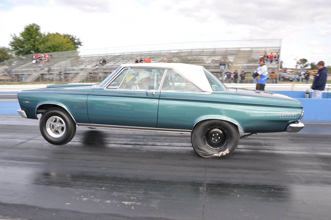

Awesome 65. I'm presenting working on a 65 with 70 440 that I acquired from a senior gentleman who just...gave up . Did you move in the rear springs or are the widest tires/ slicks you could fit ?
Great car. Be safe.
Great car. Be safe.
thank you for the compliment. i did move my rear springs to the frame-rails and added a 3" mini-tub. reference:
http://s596.photobucket.com/user/mcreglow/media/DSCF2442_001_zps85549416.jpg.html?sort=3&o=65
i'm running M/T 10.5 x 31W ET drag on the rear. i have since replaced my mopar SS springs for caltraks with split mono-leaf springs.
let me know if you have more questions.
hope that helps,
mike
Great car. Be safe.
Thanks very much. Will look into that... as soon as snow is gone. :( .
