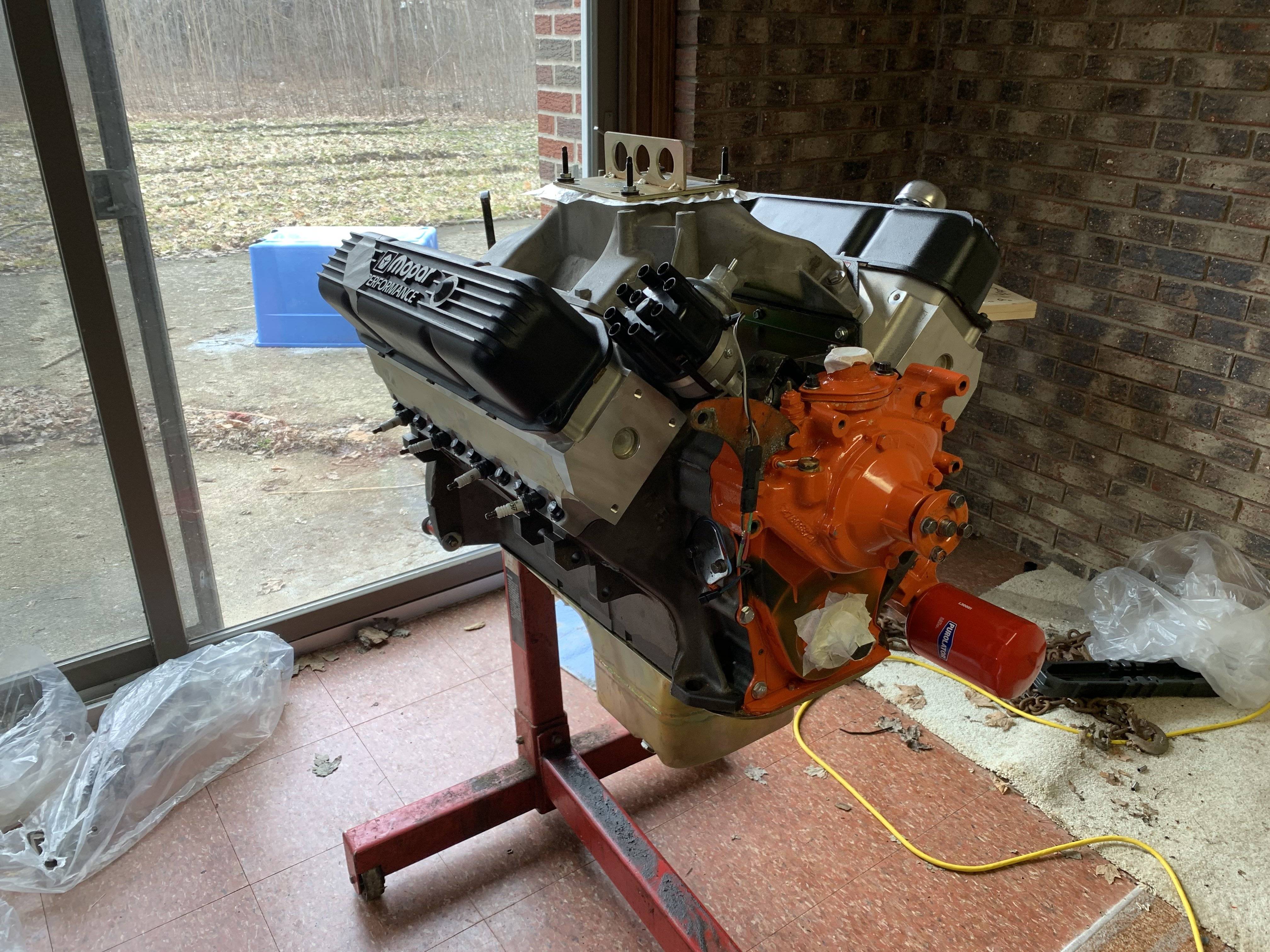

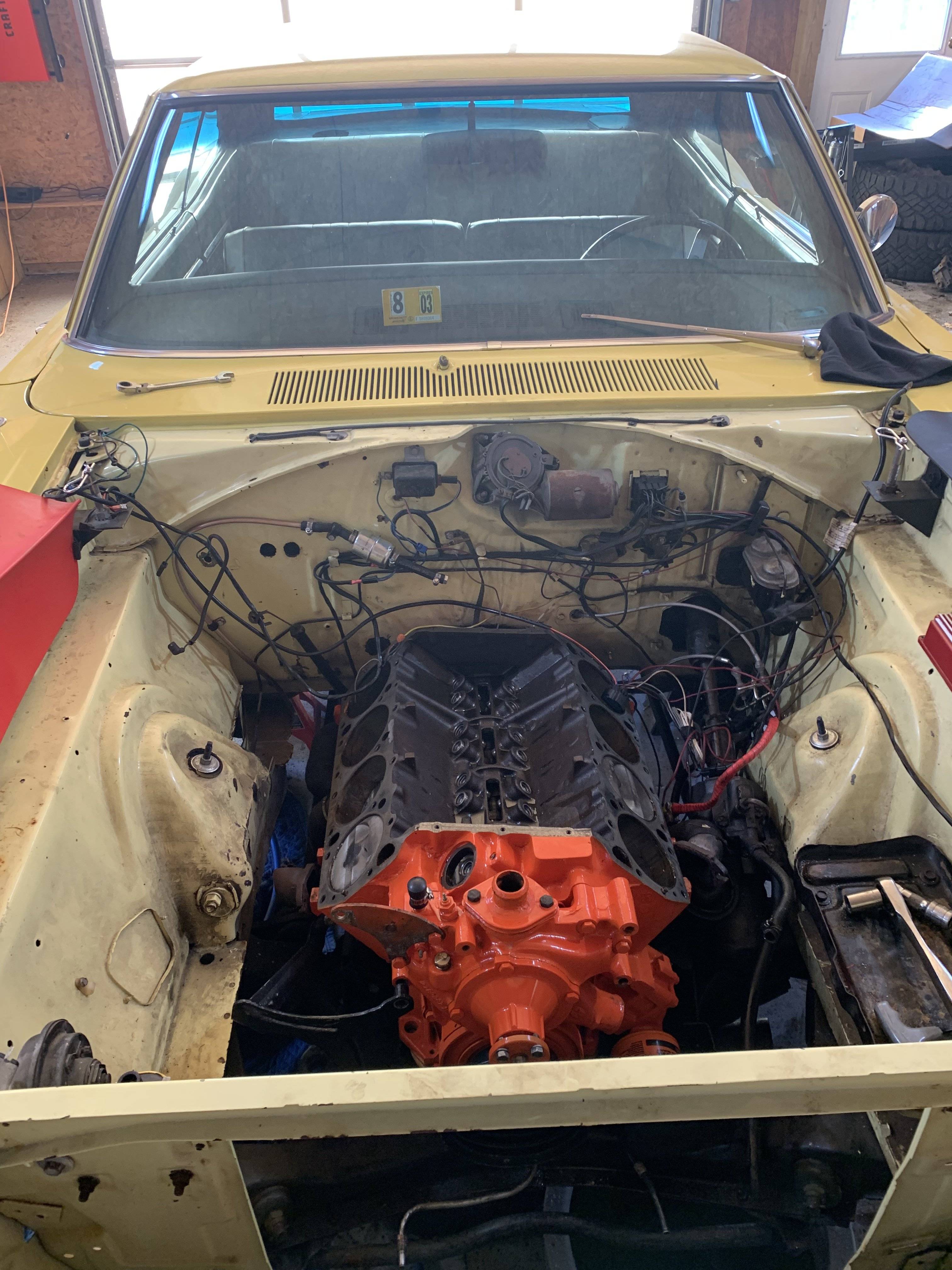

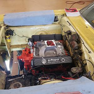

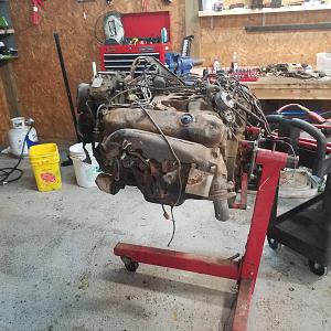

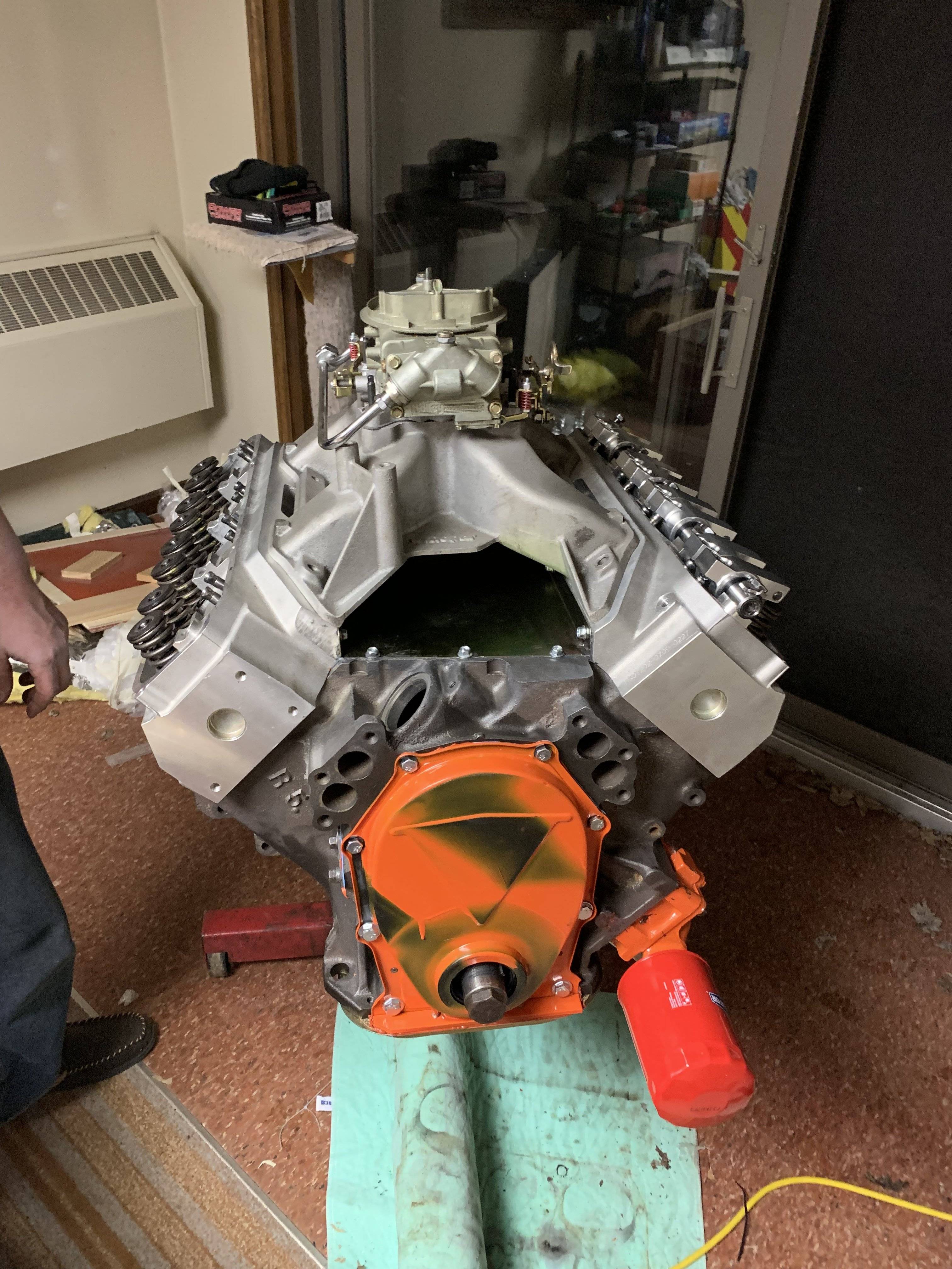

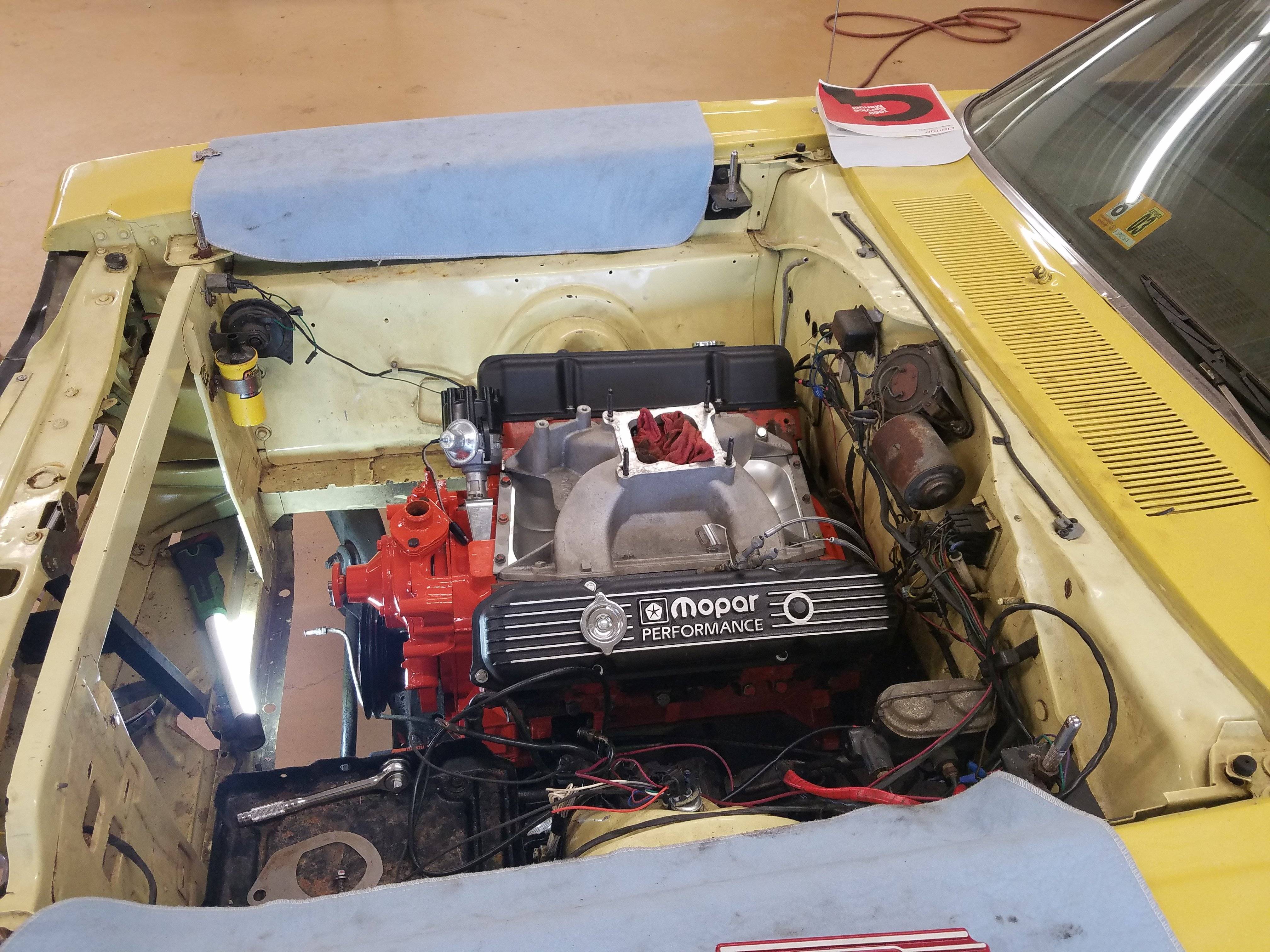

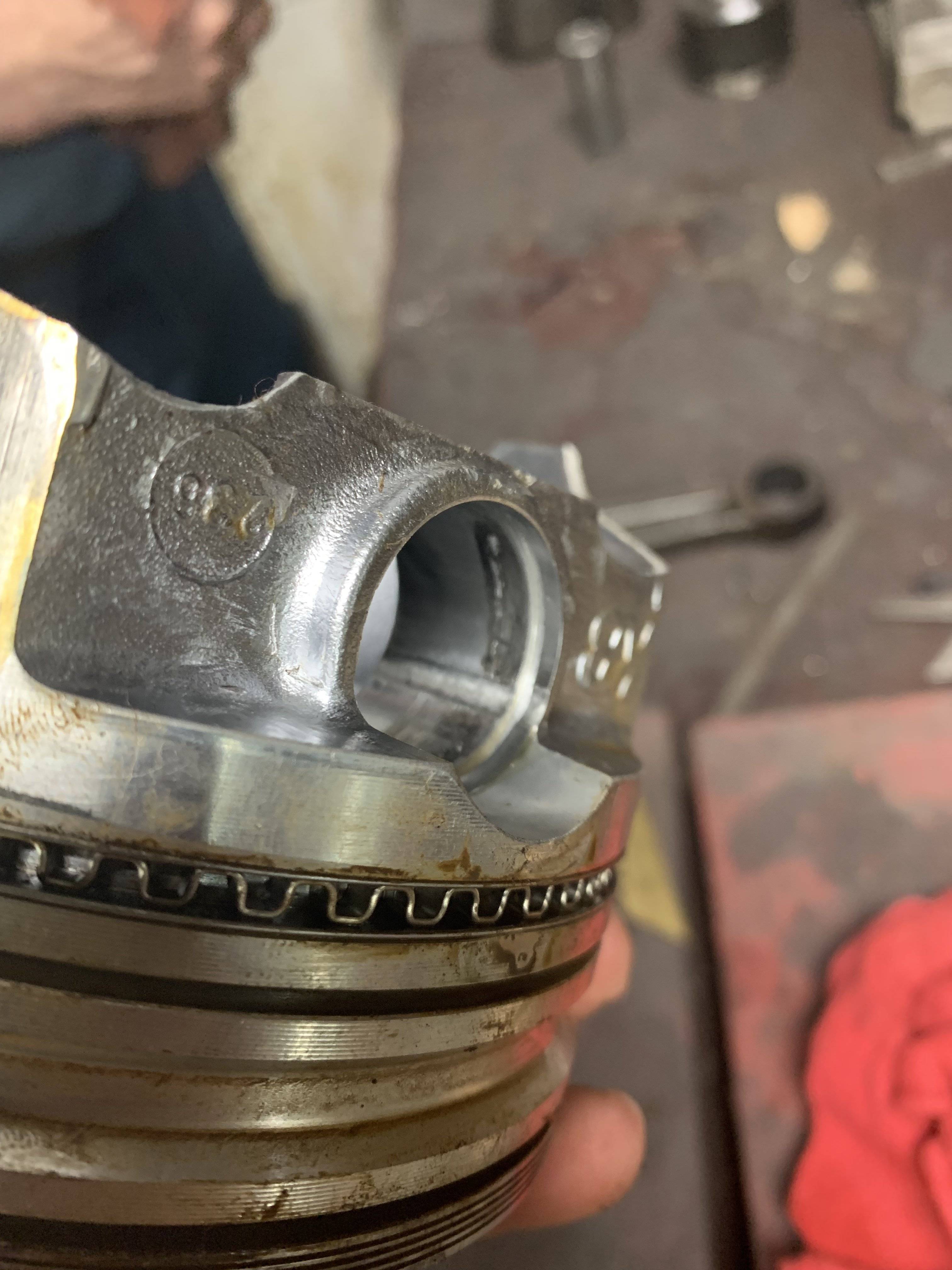

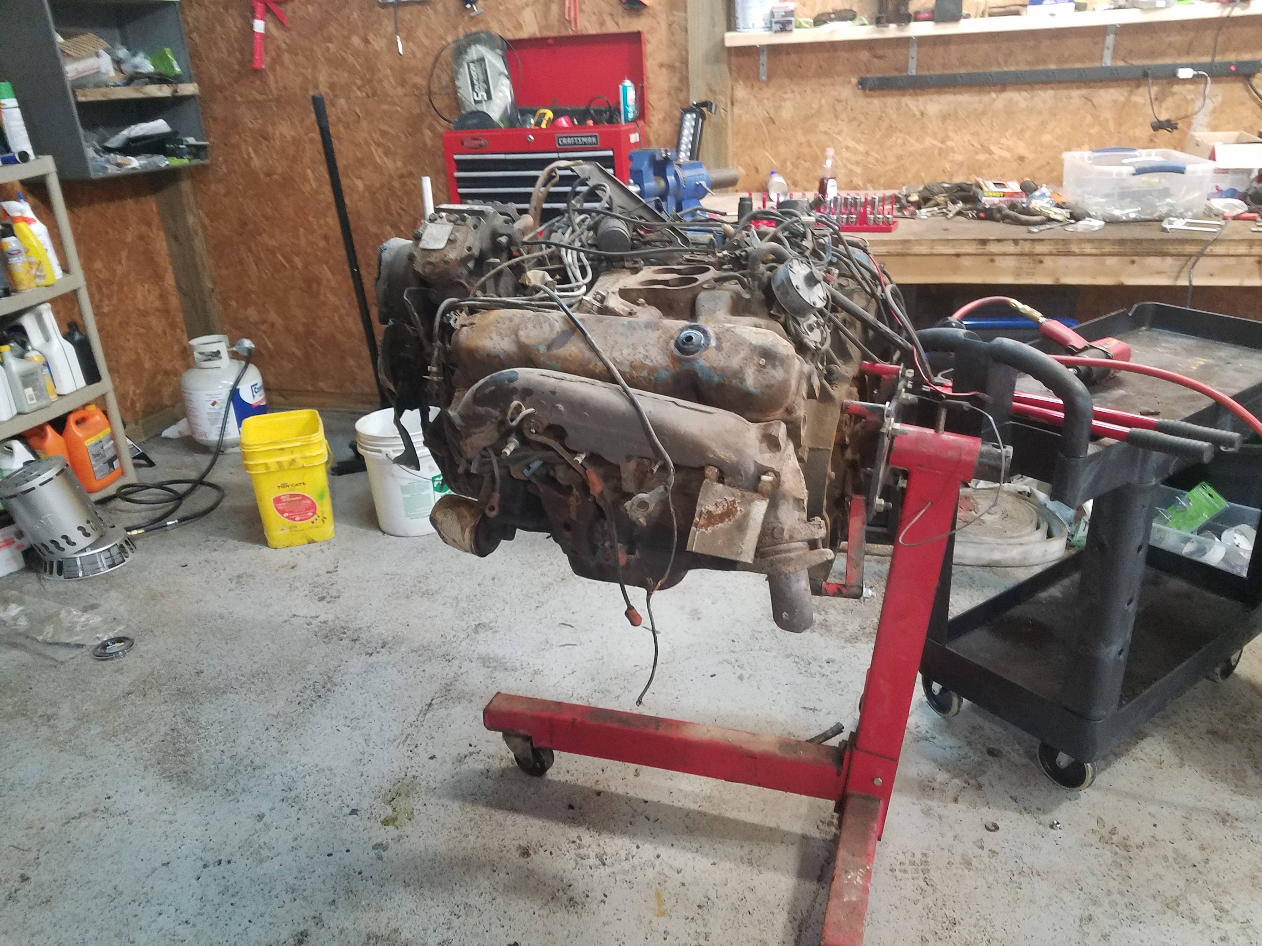

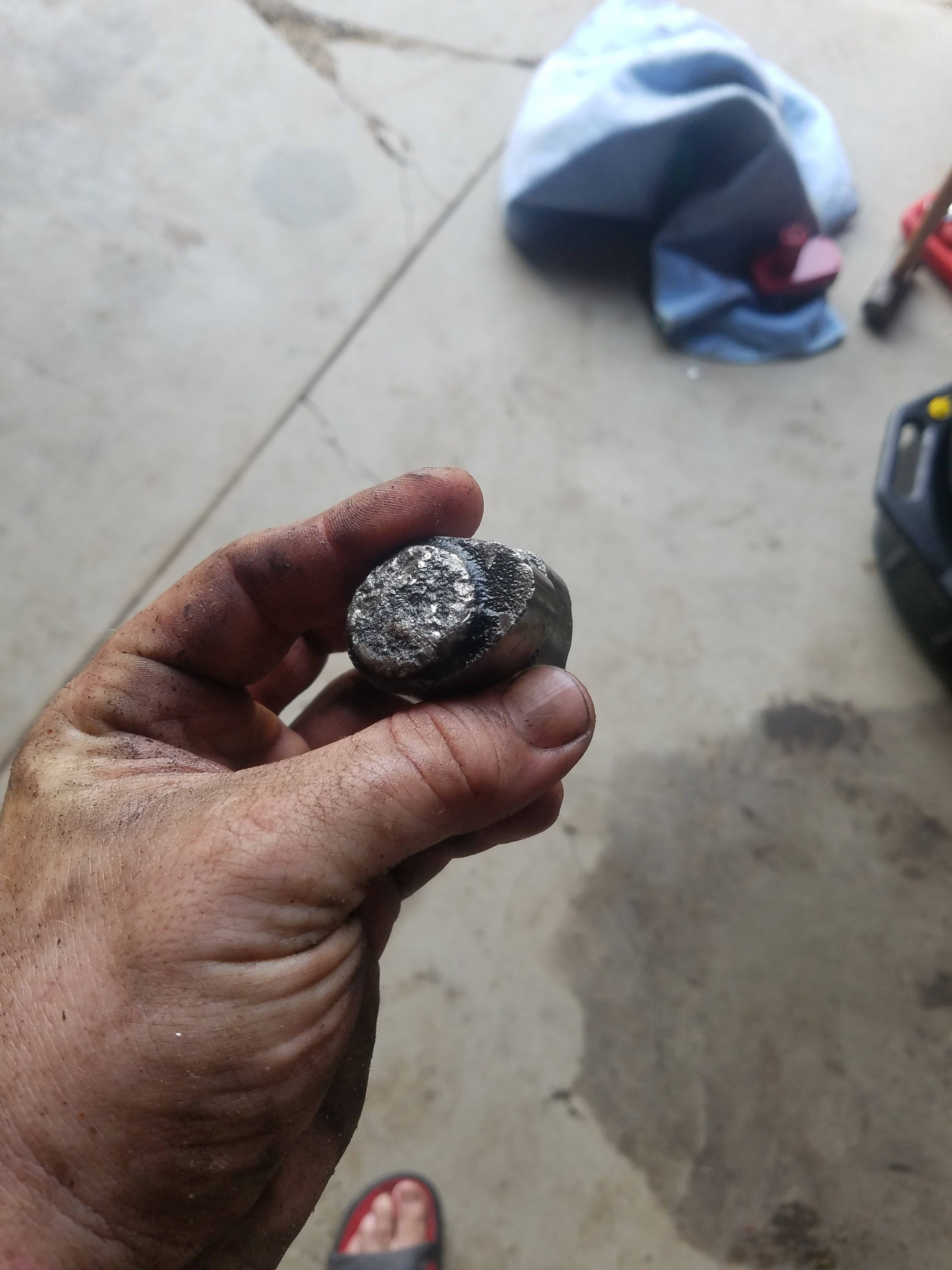

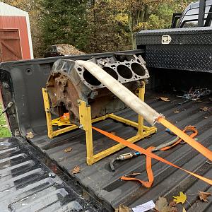

Long road to get it here, I bought it from the 4th or 5th owner, unknown 440 was placed over the oem 383, someone added the A12 scoop hood. I got it " ran when parked " not running status. Got it running threw a rod shortly after, turns out the old school purple cam snapped at the 5-6 line making it a bb4cyl for a bit. Dropped a freshly rebuilt motor, blew a cyl wall out, on the initial shake down run, pulled that, dropped in one I did all the work on except the machining part. In my basement over the winter. Got it running the weekend of Mopars at the Red Barn 2019.
Now it runs pretty good about 50% of what it could be. Trans is buggered, dizzy seems to cut out at higher rpm, and drive shaft or u joints need to be addressed.
Always working on it trying to make it better. If you see me around feel free to stop and talk. If you want to see the progress in near real time Instagram tag " #fumblebee "
Car specs are
1969 WM23 Superbee now yellow
1975 440 30 over, PS, MB
727 auto with shift kit
3.55 rear gear, w/cone type posi

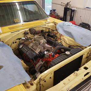

Motor stuff
Mopar performance M1 intake
4150 based Holley Carb 800 cfm

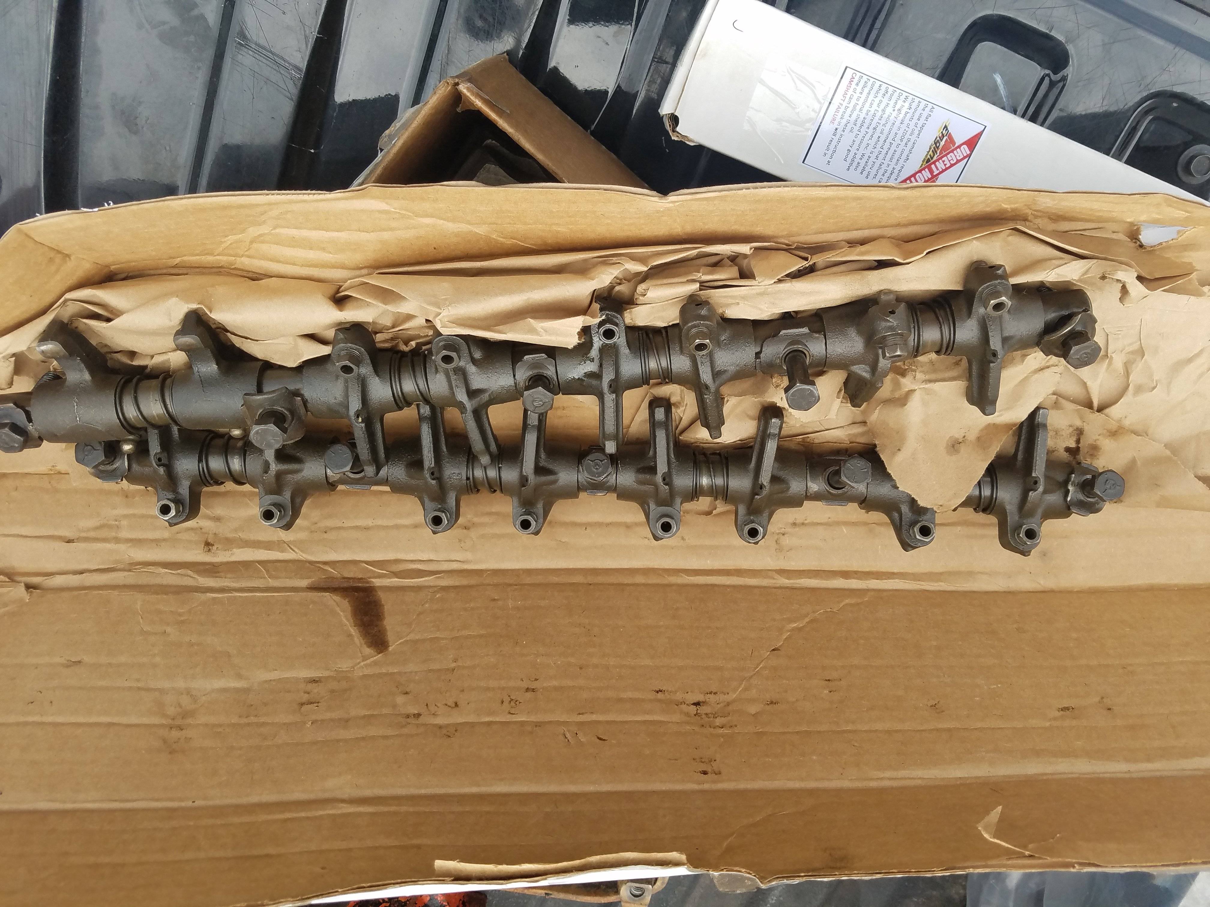

Hugh's Cam hydraulic flat tappet

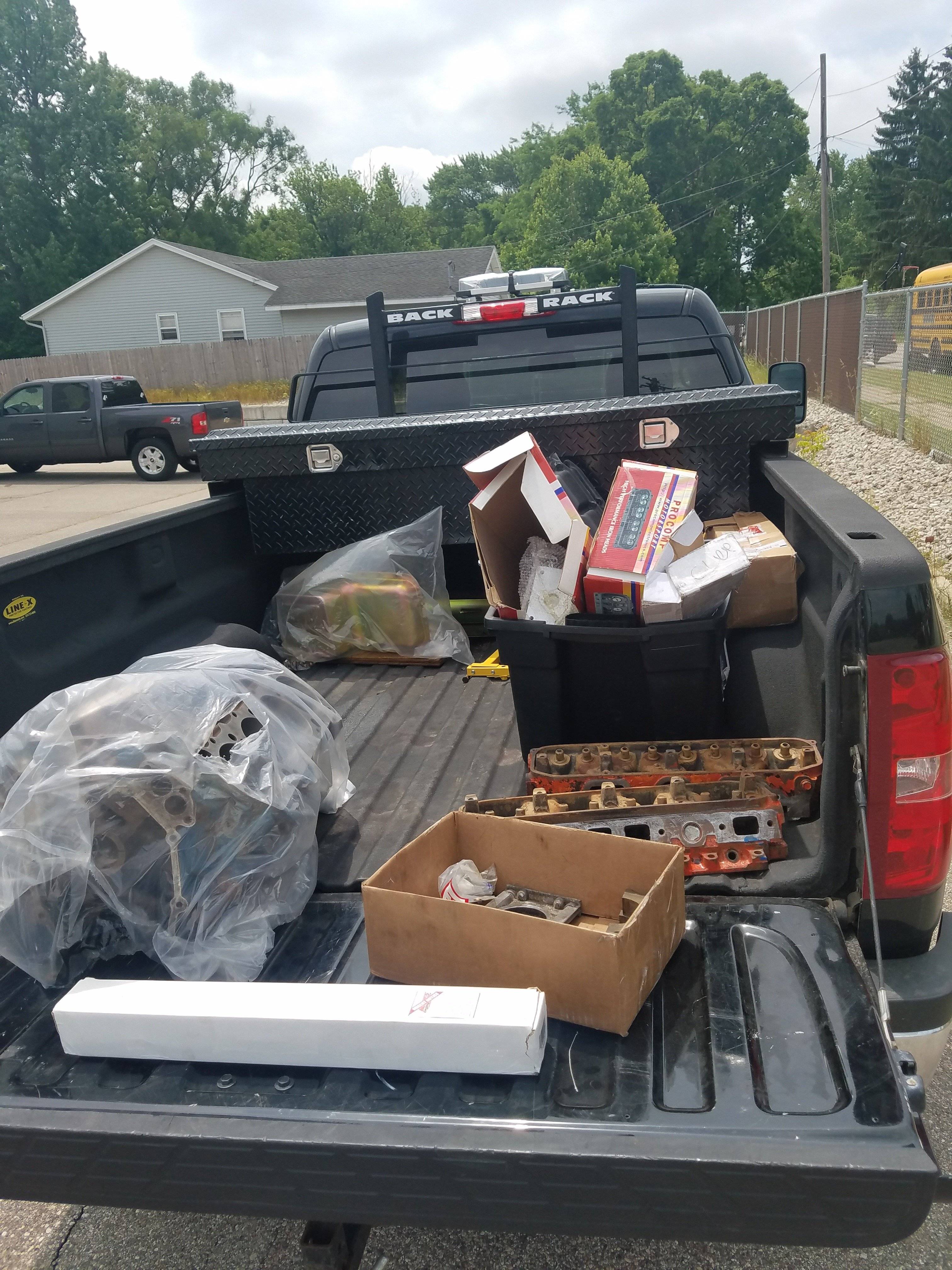

Procomp Heads 84cc closed chamber ( estimated at ~10:1)
440 Source 1.6 ratio rockers
Icon Forged pistons with coating on sides/skirt
Proformer Dizzy w/Accel ceramic wires
MSD 6AL with accel super coil
Holley red fuel pump
Melodeon 7qt pan, and high volume oil pump
Melodeon high flow water pump
Be Cool radiator with twin fan electric
Mechanical oil pressure, water temp and AFR gauges in cab.
