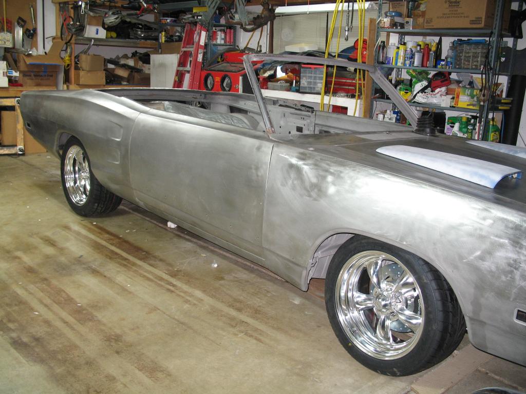

1969 CORONET 500 CONVERTIBLE FIT & FINISH BEFORE BODY & PAINT
About this Mopar:

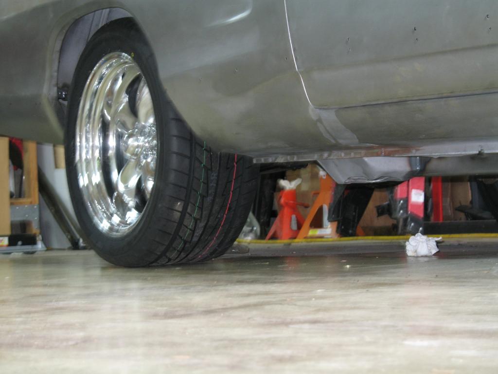

RIDE HEIGHT IS ABOUT 4 " LOWER THAN STOCK
2" DROP SPINDLES
HOTCHKISS SYMETRICAL ROAD RACE LEAF SPRINGS WITH 1 1/2 " BLOCKS. SOME HOW I GOT THE TRANS GEOMETRY TO MATCH THE STOCK REAR GEOMETRY.
REAR WHEELS ARE CUSTOM TQ 2 POLISHED 18X9.5 WITH A 5.5" REAR SPACE, THE TIRES ARE 285 40,S... THEY FIT PERFECTLY CENTERED IN THE STOCK WHEEL HOUSE WITH PLENTY OF CLEARENCE ON BOTH SIDES.

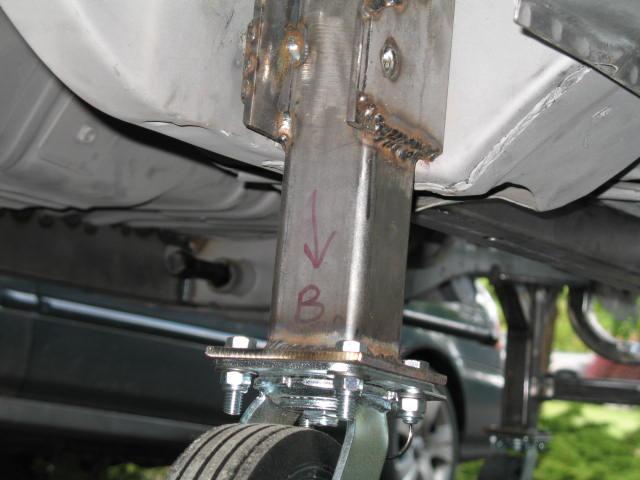

FRONT WHEELS ARE 17X8 WITH 225 40,S... THEY FIT VERY NICE AND HAVE PLENTY OF ROOM TO TURN... MADE SOME SWEET DOLLYS AND OFF TO PAINT. GETTING A NICE REMOVABLE CUSTOM 6 POINT (TIGER CAGE) VERY TASTEFUL AND ASTHETICALY APPEALING OF COURSE. MORE PICS OF PAINT & CAGE SOON !

Thanks for the pics and i agree the rollbar set up is very tasteful. The stance on the car looks nice too after lowering. Wheel dollies are cool!
