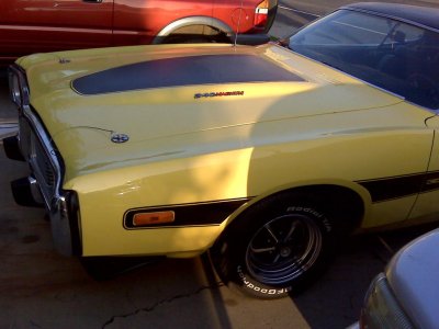

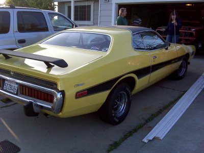

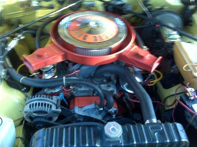

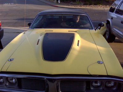

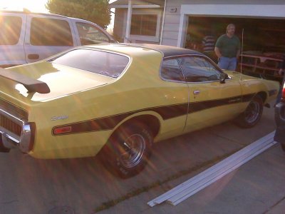

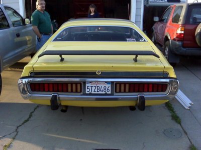

This is one of my better running toys, I picked it up from a buddy of mine who could not get the brakes to work. Neither could I, thanks to some help from the A body site, I switched around the calipers, they were backwards and could not be bled completely! Stops on a dime and leaves a nice burnout. Still need to adjust the kickdown(any advice?). Originally a 318 2 bbl, now a 340-727-3.55. Gets 20+ mpg and looks fast standing still. Future? Bucket seats and console shifter would be cool!:head_smack:
