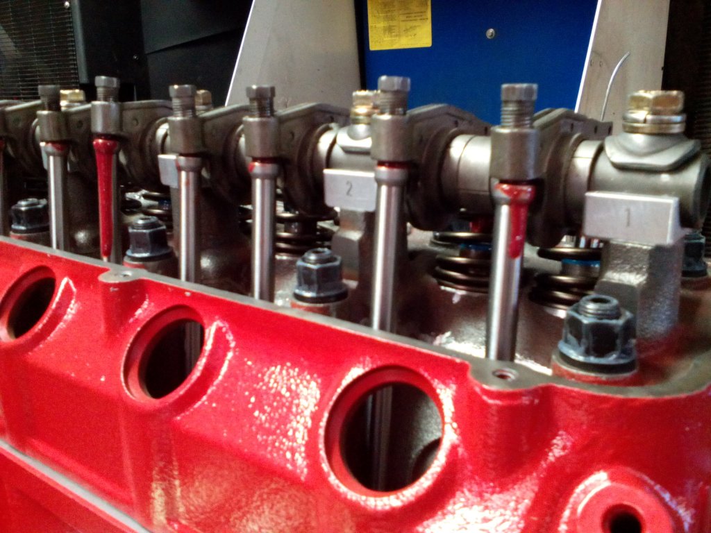

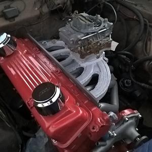

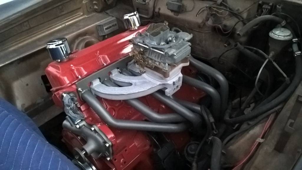

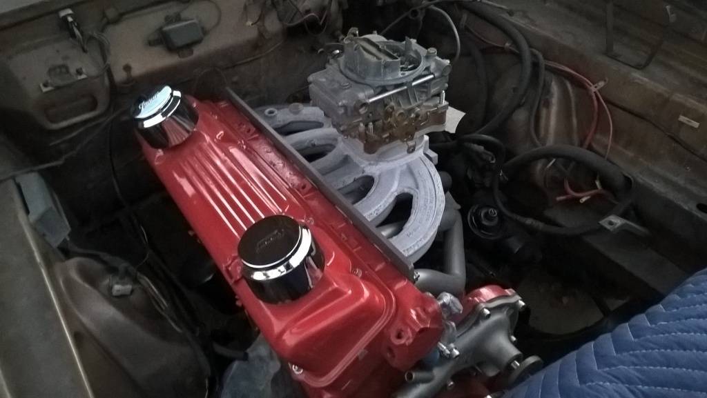

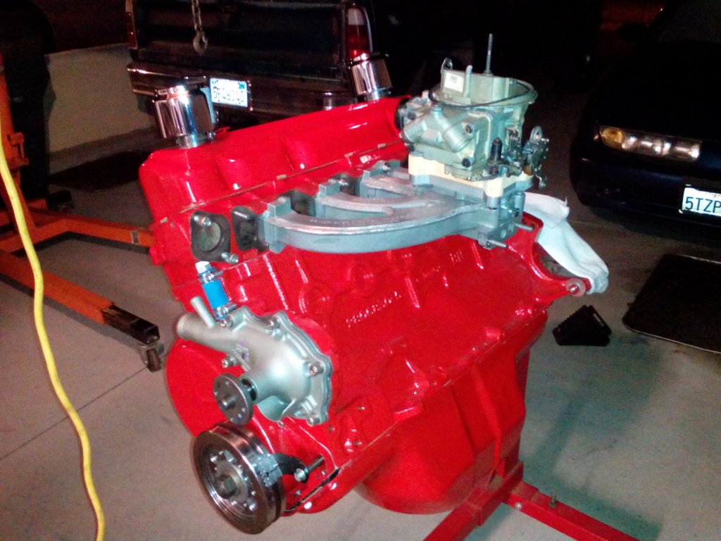

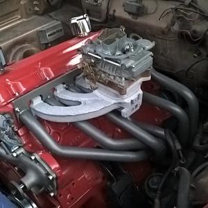

Update-August2017, Now my 225ci "leaning tower of power" is equipped with the modified 1bbl intake (into a 4bbl intake)and Holley #1850 600cfm 4bbl carb.

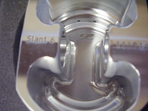

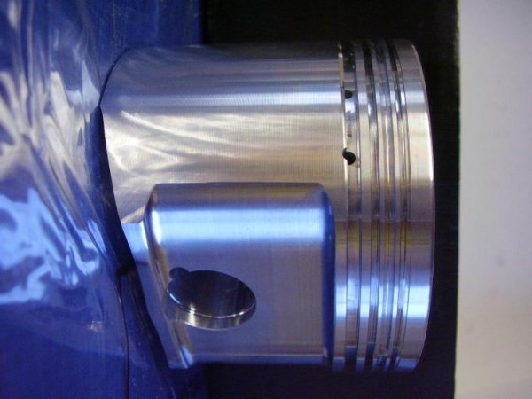

A lot of nice internals too like custom CP pistons (10.4:1 comp ratio) highly modified stock forged rods , Romac balancer, Double roller timing chain, Manton custom push rods, custom Comp Cams solid lifter cam, lifters & beehive springs, Reconditioned OEM rocker arms, Ported cylinder head w/ stainless 1.700" & 1.440" long stem valves, custom Rockershaft spacers, Mopar Performance 6into1 header, Electronic ignition w/ MSD coil, ARP main studs and head studs and Cometic gaskets.
Update-August2017, Now my 225ci "leaning tower of power" is equipped with the modified 1bbl intake (into a 4bbl intake)and Holley #1850 600cfm 4bbl carb.A lot of nice internals too like custom CP pistons (10.4:1 comp ratio) highly modified stock forged rods , Romac balancer, Double roller timing chain, Manton custom push rods, custom Comp Cams solid lifter cam, lifters & beehive springs, Reconditioned OEM rocker arms, Ported cylinder head w/ stainless 1.700" & 1.440" long stem valves, custom Rockershaft spacers, Mopar Performance 6into1 header, Electronic ignition w/ MSD coil, ARP main studs and head studs and Cometic gaskets.
