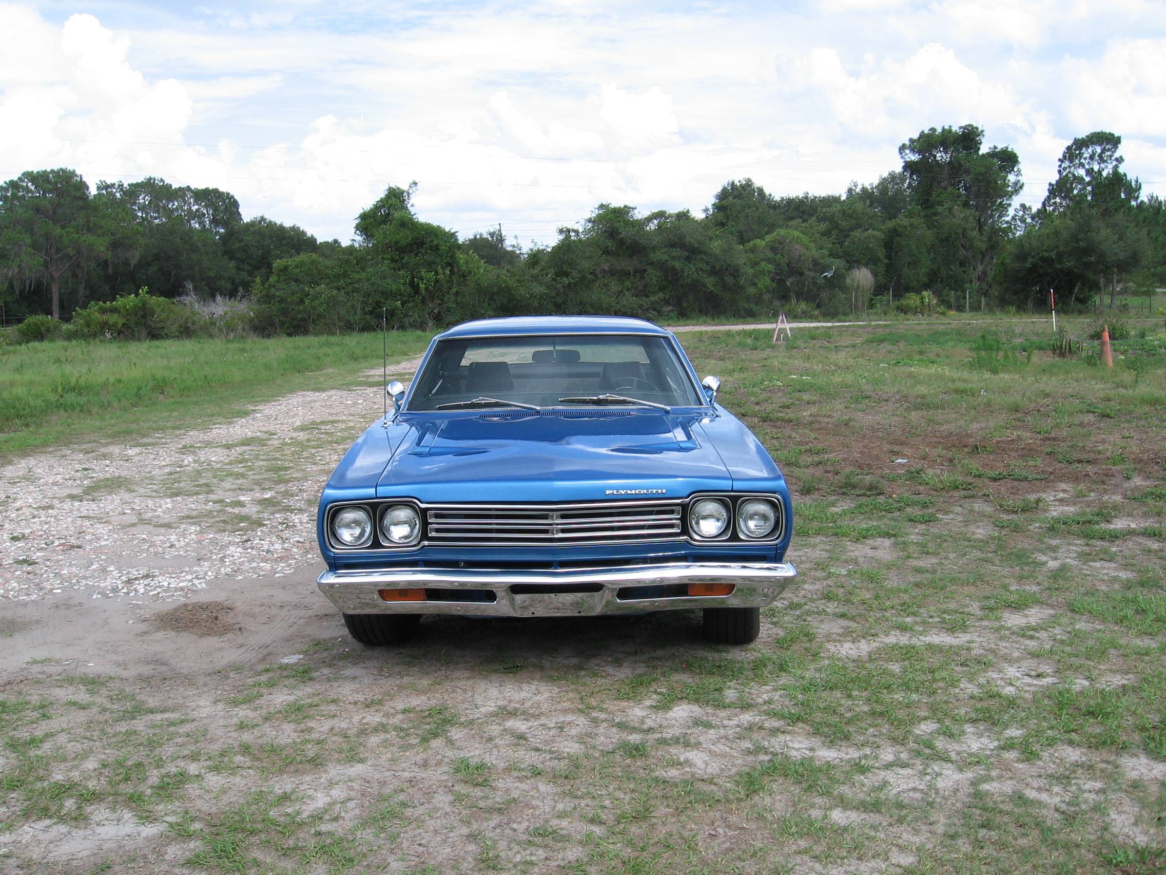

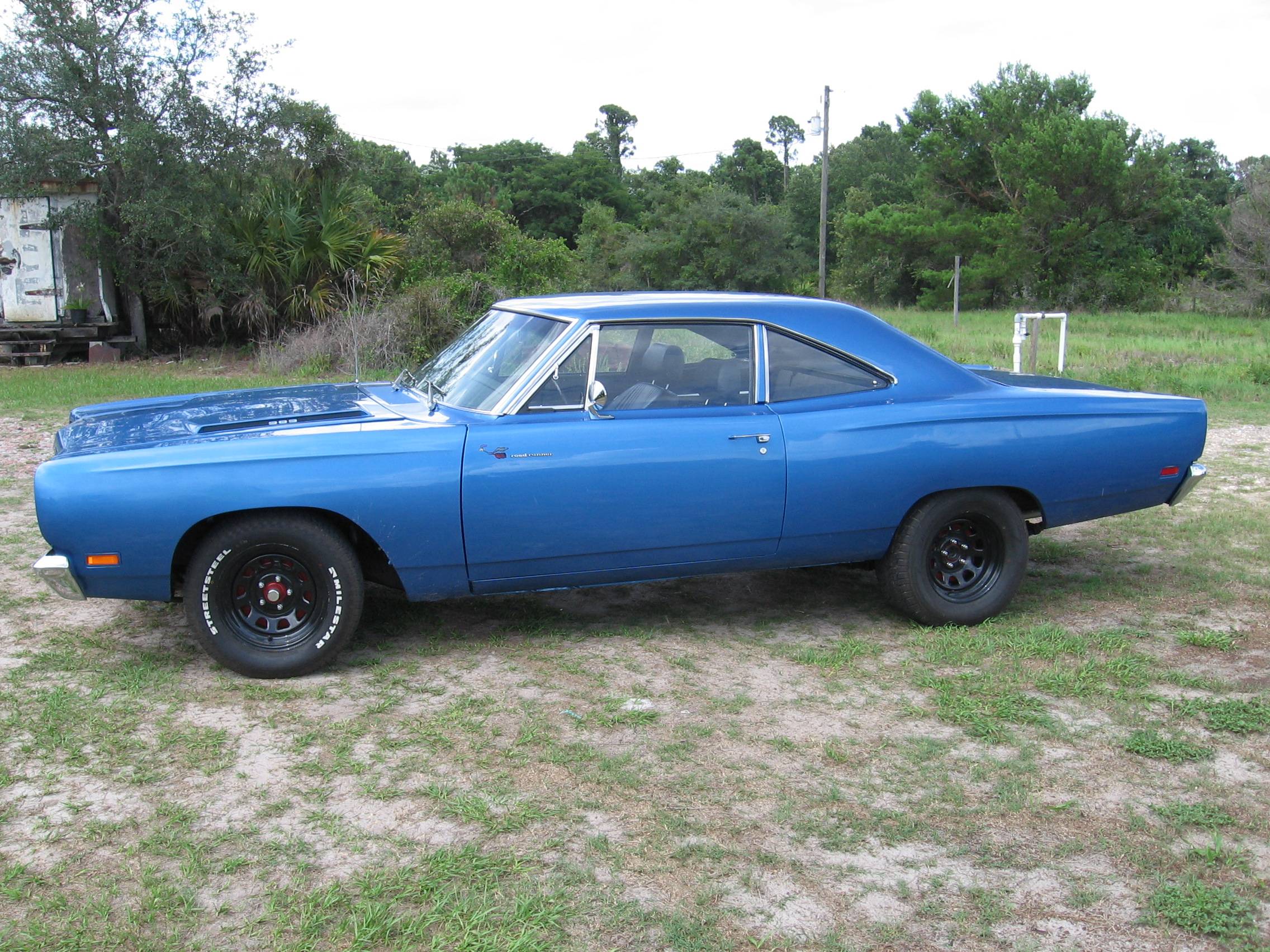

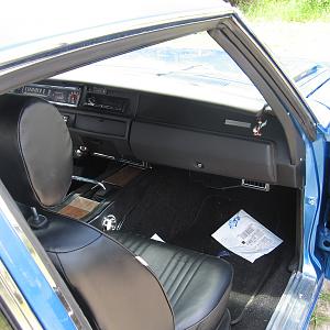

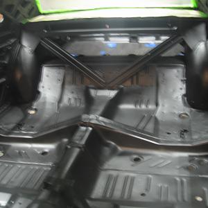

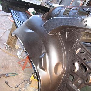

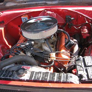

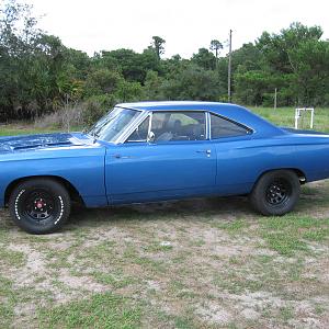

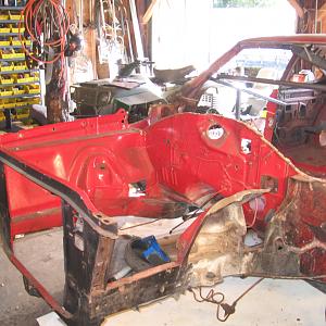

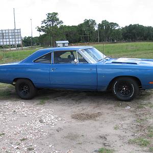

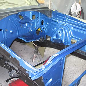

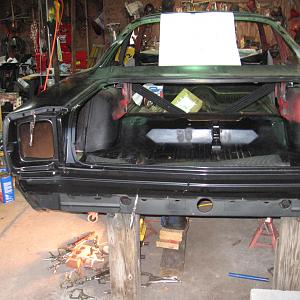

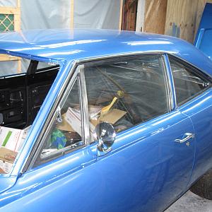

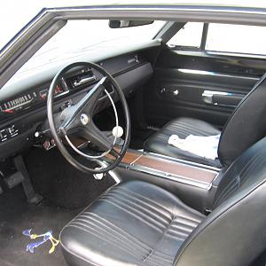

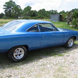

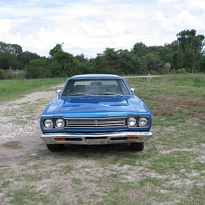

Mid 69 production 69 runner. 383 four speed. Now will have bucket seat's with console. Was a bench seat car. Ground up restoration. Was a red car. Now will is B5 blue. With added Royal blue flake over the b5 blue. Just to add some pop to it. 8 3/4 rear end for now with 3.55 gear's. Single four barrel with Holley intake. A833 transmission. Have 15 inch rims. Manual brake's front and back.

Just to up date you guy's the bird is out of it's cage. LOL. Drove it on the 10/13/21. Motor run's fine except for some jerky ness when at speed. It has plenty of power but just has hesitation to it. Thought it might be the timing but found out had some loose clamps on the fuel line. Spotted air in my fuel filter. So went through and tighten up the hose clamps at the fuel tank and fuel pump where I have short flex lines to connect all the steel line's now it run's fine no more jerky feeling when cruising at normal speed. Will up date my garage soon.
Like most of you guy's know we are never really done. Up grade exhaust or something else. But for now going to drive the heck out of it and show the world these cars are still alive after fifty year's. Oh by the way cragar SS mag's are on my list next with Mickey Thompson white letter tires.
