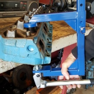

I'm liking this style compressor!

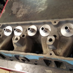

Made up a valve organizer.

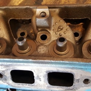

The stock valve guide bosses.

Checking installed height.

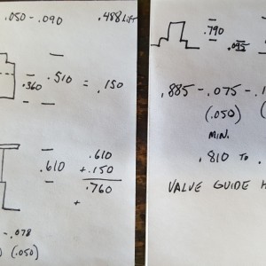

Doing the math. (Don't use these numbers)

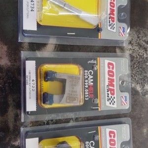

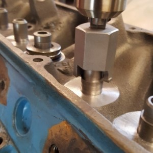

These are the cutters I'm useing.

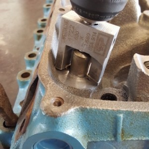

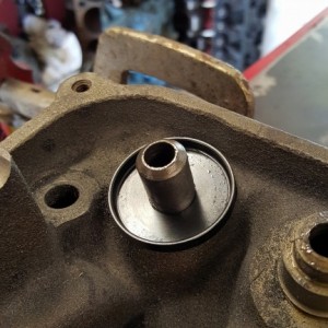

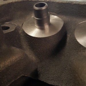

Cutting the spring seat.

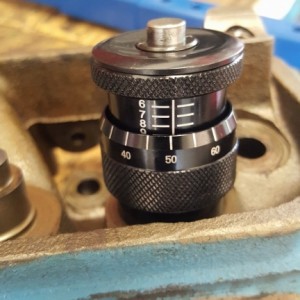

Checking the spring cup that I'm useing.
The cutter doesn't work too bad by hand. You need a heavy amp. 1/2" drill that turns nice and slow. (Tends to chatter at higher speed)

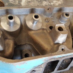

Useing the valve seal cutter. Once you get your height, just stack some washers for a stop under the cutter.
That's it. Not too bad of a job. The hard part is figuring out the valve spring that you need, the parts that will work with them. The math needed to make it all work.
