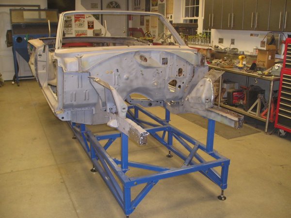

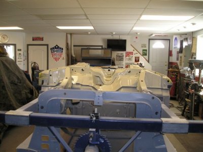

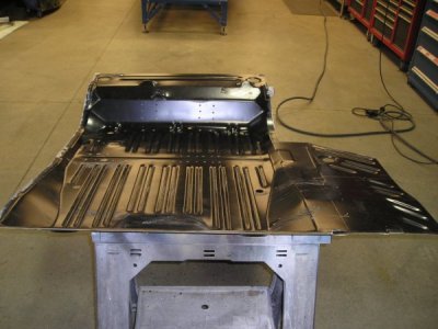

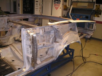

Where did you get that blue body stand? Are plans available?
Thanks!

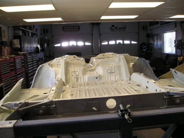

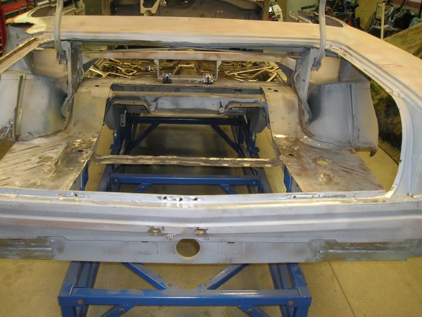

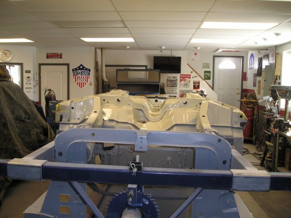

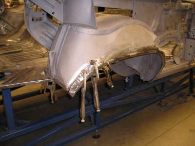

Hi Michel, I made the body jig and sorry, I didn't keep the plans as they were scratched out on the back of a cocktail napkin. There's a thread on here somewhere about it though. Basically, just get a frame spec chart for your car, pick your mounting points and build it from there. Make the corner braces angled so you can get under it and make it a bolt together affair so you can knock it down for storage/transport.

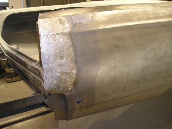

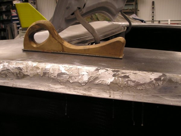

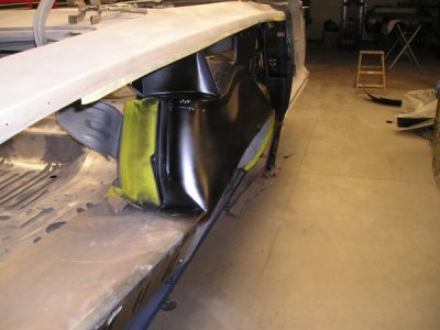

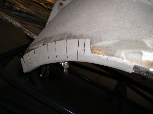

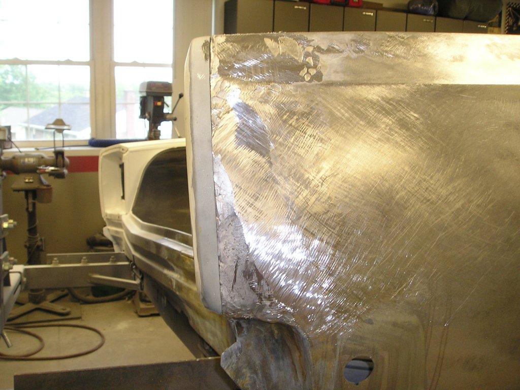

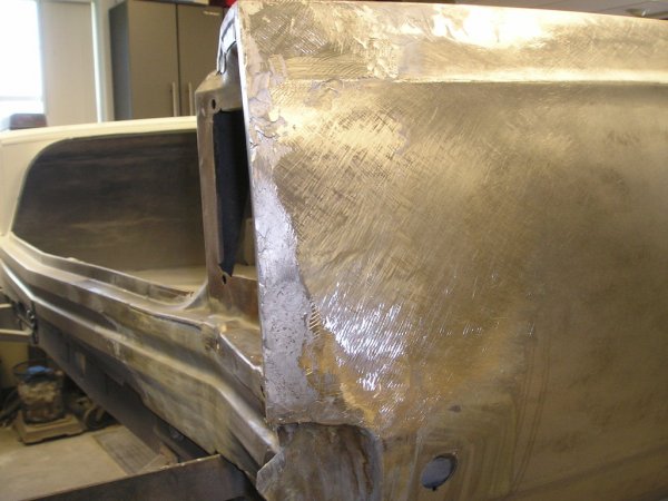

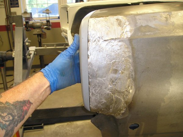

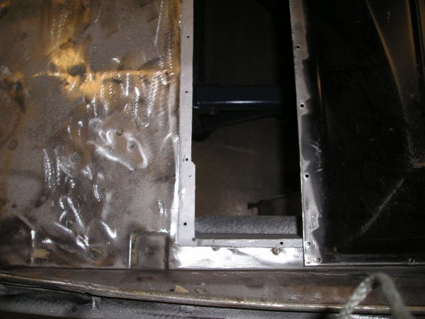

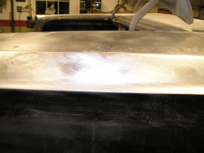

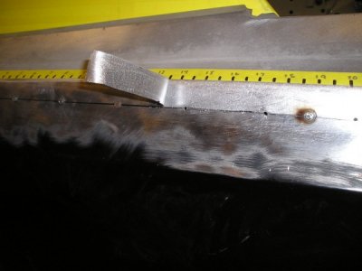

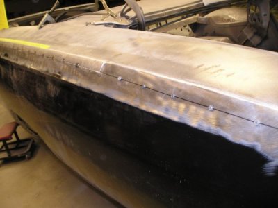

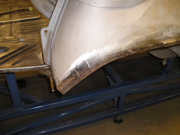

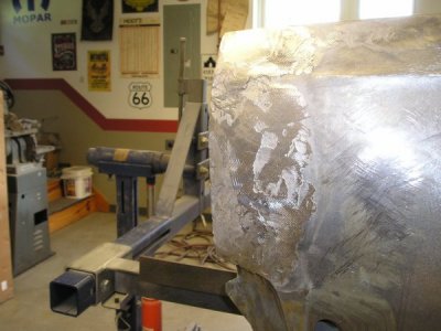

Pete, I came here sneaking around for photos that might giveaway your latest "what the heck is it" thread - and I wound up looking at the photos of the lead tinning you did on the rear quarter. What a beautiful, beautiful job.
I know that there's a whole debate on lead vs. epoxy/fibral style fillers these days over cracking concerns, but this just looks perfect - the kind of result that allows for worry-free sleep :)

Hahaha, that's awesome. I never thought anybody would be "sneaking around, looking for clues" in here. Thanks for the props on the lead work. It's becoming a lost art for sure., but I kind of enjoy it ( well, at least when it comes out well.) I do really need to update this ancient photo gallery as some of the other pieces are coming in to place.

I figured I'd look in here after I found out that one of the other posts referenced the jig you made to keep the unibody square.
I think that reasoning on the leadwork applies to just about anything bodywork related - "...WHEN it comes out well." Whatever the case, it came out better than well!
